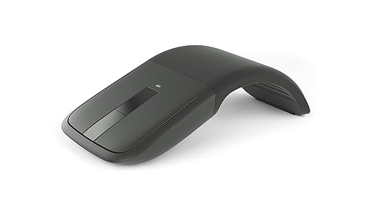

While the rest of the family was downstairs playing Monopoly, my son had gotten ahold of my wife's wireless mouse from her Microsoft Surface and proceeded to see if it would flush in the Drake II. It got wedged in there and a snake I keep didn't help (it probably made the situation worse). Plumbers were called today and they couldn't get the thing released either due to the weird shape and semi flexible design of the mouse....it just wedged and wouldn't let go.
Finally they gave up and I called Supply.com to see if they could just sell me the Drake II bowl and not the entire unit. They said yes so hopefully the new piece will arrive in a couple of days on a short drive from north Georgia. So my son has cost me another several hundred dollars (parts and labor). I love him dearly but I really wish he's stop this. I thought he'd grown out of it....but I was clearly wrong. And we did destroy the Drake II bowl just to verify that it was indeed the missing mouse (it was) and nothing else was in there (it wasn't).

Dude, He's already clogging the main sewer line with toys. The 3" trapway on the Caroma could make that even worse.
I have one customer in Seattle whose kid flushed forks down the toilet. He might have quit doing that finally, as it's been a while since I've heard from them. With a lot of that, I pull the bowl and use an auger from the low end and push it back out the way it came in.
The auger I use is much larger than the one that the home centers sell.
It would have pushed the mouse out. I'm guessing your plumber had the standard 7/8" auger.
Those don't do much.

Perhaps. And yes, he did try to push the object out as you described, but the auger bit wasn't any bigger than the one I have and it actually got caught with the mouse and stuck for awhile before it was finally freed. I do think the odd shape of the object made it especially difficult.
