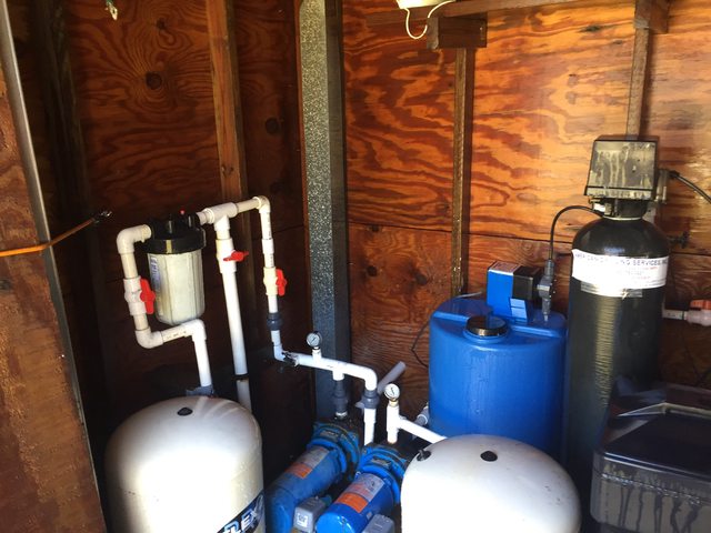

Here’s a picture of a above ground well pump setup. It has 2 pumps. One pumps water from well to a storage tank. The other pumps water from storage tank through carbon filter and water softener to the house. Each pump has a pressure tank.the pressure tanks are white in this picture. The blue tanks contains chlorine that is used in the storage tank.

That's good info. I've never seen a setup quite like that before. All my well water homes had a buried pump that supplied a tank, which then fed a softener before branching off to water heater, etc.
