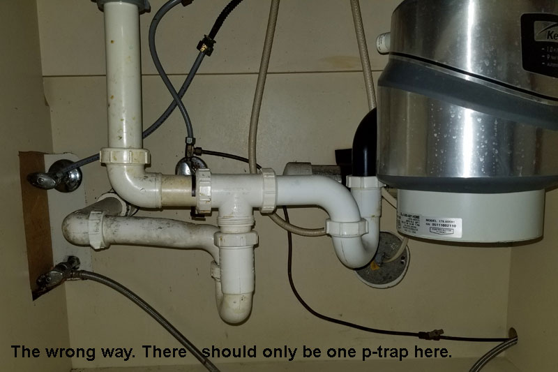

Here is the old sink and piping that was removed.
The wrong way. There should have been only one trap for this.

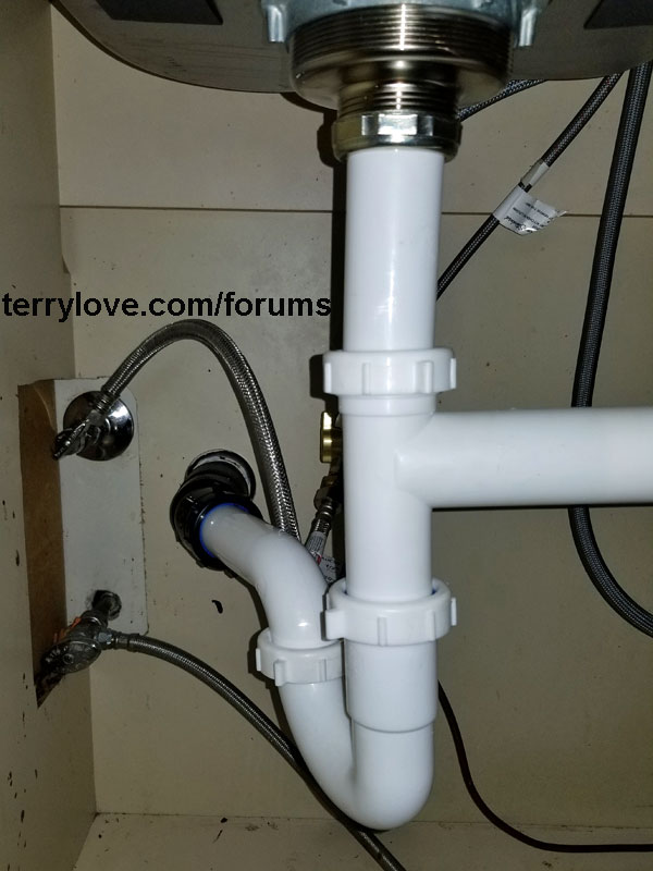

New basket and disposer, the Insinkerator 880LT 7/8 HP
A little more direct to the p-trap with the 22 bend from the wall.

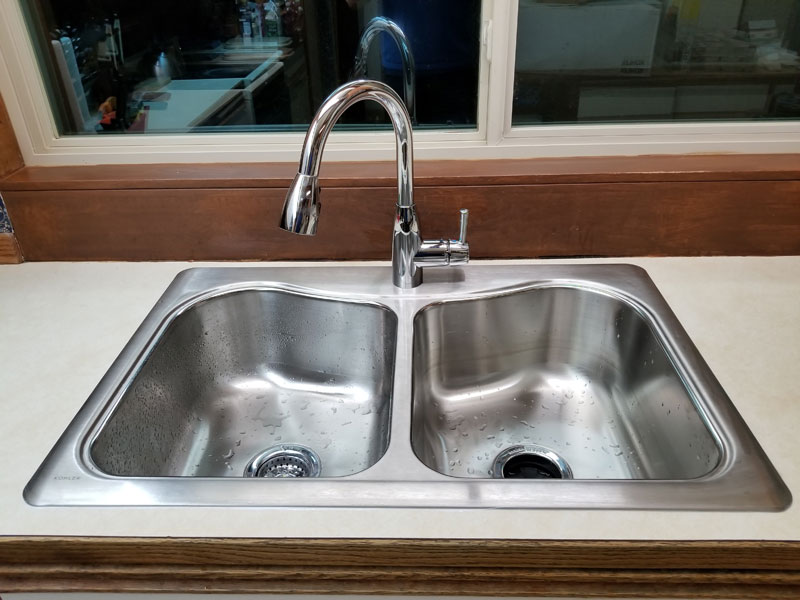

The new Kohler stainless steel sink.
The faucet is an American Standard, but Kohler makes nice faucets too.

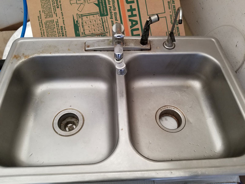

The old one that came out.

That's a fancy looking sink. I really like the shape of the water bays!
