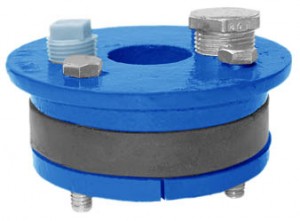

I'm looking at the cap to my well trying to figure out how to remove the cap. I need to determine pump depth, and static water level. It looks like a bolt has been modified to allow water line to extend from the top of the cap.
1. is there a way to remove the modified bolt at the pvc pipe, or should i loosen up the other 3 and see if I can get it out with just 3 loose bolts?
I will probably be replacing the cap and re-working the plumbing and electrical.

You can try with just three loosen, do not remove them. Use a large screwdriver or the claw of a hammer to get under the cap to pry it off.

The bolts will not turn. I hit them with som WD-40 cause I ave no penetrating oil. About to go try again. There are actually only 2 that can be turned without hitting something, they modified the other two....Why me?

The threads are on the bottom plates so penetrating oil would have to go down through the rubber seal to reach the threads. Probably not going to happen.
You can always cut the casing a couple inches down.

Can you get a longer wrench? Preferably 6 point box wrench, or will a box wrench not access the problem hex head?
I expect that you could grind the head off of one of the bolts with a cutoff wheel. Wait for people to say that is a bad idea before implementing that. My thinking is that this is not a split well seal, and it should be safe.

EDIT: well this is scary. There are well seals with a solid top plate and a split bottom plate.
If you had working bolts diagonal from each other, I think you could grind off the heads of the other two. But adjacent bolts look dangerous.
I wonder if somebody could weld something on top of a bolt to give something to grip.

Yea I see what you are talking about. I'm sure mine was modified because some crazy guy wanted max flow (pipe is 1.5" coming from seal all the way past bladder tank) so that is why they modified the cap. Could I just try to pry up without loosening any bolts, or just grind off two opposite bolts and try to pry like that first without loosening or cutting the other two? Or I could just cut the two "modified" bolts on either side of the PVC pipe as this side, even if split back plate, should get caught by a coupling or clamp on inside of casing?

Boyce, you need a well seal puller. Steel rod with 1/2 npt threads & a shackle screwed into the vent port.
