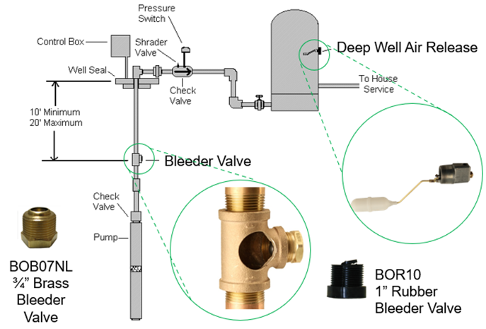

At 4-1/2' below grade, it's well above what the manufacturer says is typical.
The image from the Boshart site, specifies their Bleeder valve is to be located 10' minimum, 20' maximum below the well seal.
Perhaps the distance will need to be similar while using a pit less adaptor.

My pitless adapter was 1' below grade and the bleeder orifice is now 3.5' below that.
There's a 6-8' horizontal run of 1" poly pipe from the pitless to a 3/4" copper outlet that's runs 5' up my wall. It's wide open, no pressure tank. There's roughly 10' of elevation between the bleeder orifice and the open outlet.
I did test the bleeder orifice valve before I dropped everything back down the well. Restricting the flow at the open pitless joint with my hand closed the bleeder valve and IIRC it did drain properly.
I was concerned about putting the bleeder orifice too deep and having it fail to open due to excess pressure. I should've checked Boshart's recommendations beforehand.
