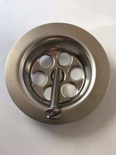

Got myself into a plumbing pickle, right at the first hurdle. We have a funky smell coming out the bath drain. Despite knowing little about plumbing, I figured removing the drain cover would be a good place to start, get a better view down into the P-Trap etc. But the screw just keeps spinning and spinning, the cover will pull up about a centimetre, but won't come off. And now the screw won't screw back down! Which raises a number of questions.
1) while it's loose, will water leak out anywhere if we use the bath/shower? Or does tightening it just prevent water going down the drain when the plug's in? I.e. is the bath and shower out of order until I find a way to get this screwed back down??
2) how might I get the drain cover off?
3) how might I get the drain cover to screw back down??
Google doesn't suggest this is a common problem, nor that just getting the drain plate off should be at all complex.
I'm in the UK, and this is what the drain plate looks like:
Any advice very gratefully received!

I now just want to get the drain cover screwed back on. The screw goes through a black plastic structure just below the metal cover, and doesn't extend much below that. So the plastic must be what the screw is supposed to anchor into. And maybe the plastic is the problem? Its threading has stripped, or it's just in the wrong position somehow? If only I could get it out, I could have a better look at it, try reseating it, maybe take it to a plumbing supply shop if one's open anywhere to buy a replacement. But it's stuck in there, neither coming out nor tightening back up...

In your photo, it looks like a grid drain cover which is just there to prevent things from falling into the drain, or to perhaps catch hair before it enters the drain.
The metal flange is likely threaded into the plastic shoe of the drain.

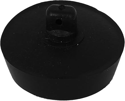

Terry, no lever at the top overflow. Stopper is just an old fashioned separate rubber stopper like this:
The drain cover doesn't screw into anything (sadly, that would have explained a lot!). It just sits on top of the drain, like this:
The screw extends down about an inch before going through a hole at the centre of three black plastic spokes, which attach to the sides of the black plastic pipe. When I pull the cover up and wiggle it around, the black plastic also moves around.
So you can take a bath with that stopper in place, right?

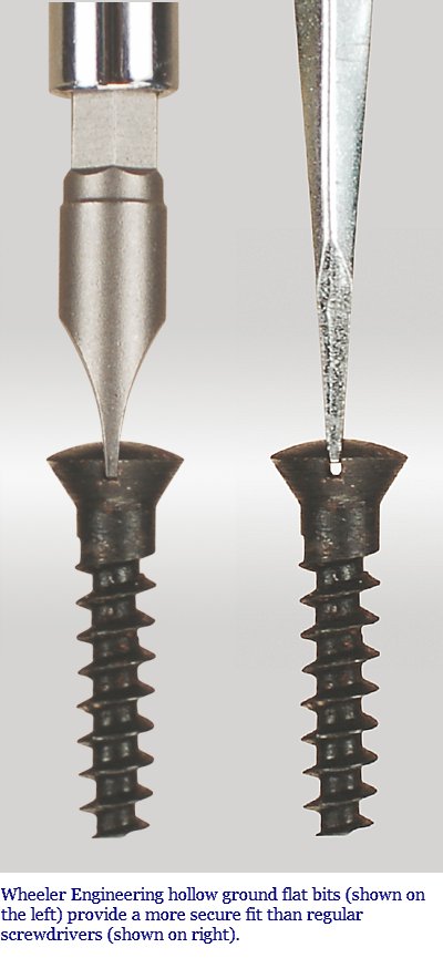

Do get a good hollow-ground screwdriver that exactly matches the screw slot. You want a blade hat is wide enough and thick enough, and not tapered end on the bit. We don't want you to mess up that slot.
The ones with the replaceable bits are often good.

Based on the 1 cm comment, Reach4's idea (wedging the black plastic shoe up before trying to tighten the screw) has a good chance of success, so do try it. Here's what I think is happening:
The metal part visible in the tub has a captive screw. The plastic part (shoe) below has a washer on top of it to seal to the bottom of the tub. The metal part also need to seal to the tub. The original installer used silicone to seal the metal part to the tub, and it is well adhered and won't budge. The installation geometry of the plastic pipes was also slightly off, so the unstressed location of the tub waste (plastic shoe) is 1 cm lower than it should be (plus however much the washer compresses). So when you unscrewed it and released the black plastic shoe, it popped away from tub, and now the screw can't engage it sufficiently to pull it back up.
Therefore if you wedge the black plastic shoe back up, hopefully the screw will catch, and you can tighten it down. Tight enough to compress the washer between the black shoe and the tub (worth checking if you can see the washer is there, and certainly worth checking for something lying on the subfloor next to the black plastic shoe, because then you need to put it back in place), but not so tight as to strip the black plastic threads. Then you can remove the wedge, and hopefully the shoe stays in place. If not, you've likely stripped the black plastic shoe and you need a plumber to replace it. (See below for one possible intermediate option). If so, check for leaks underneath while you drain a fullish tub
