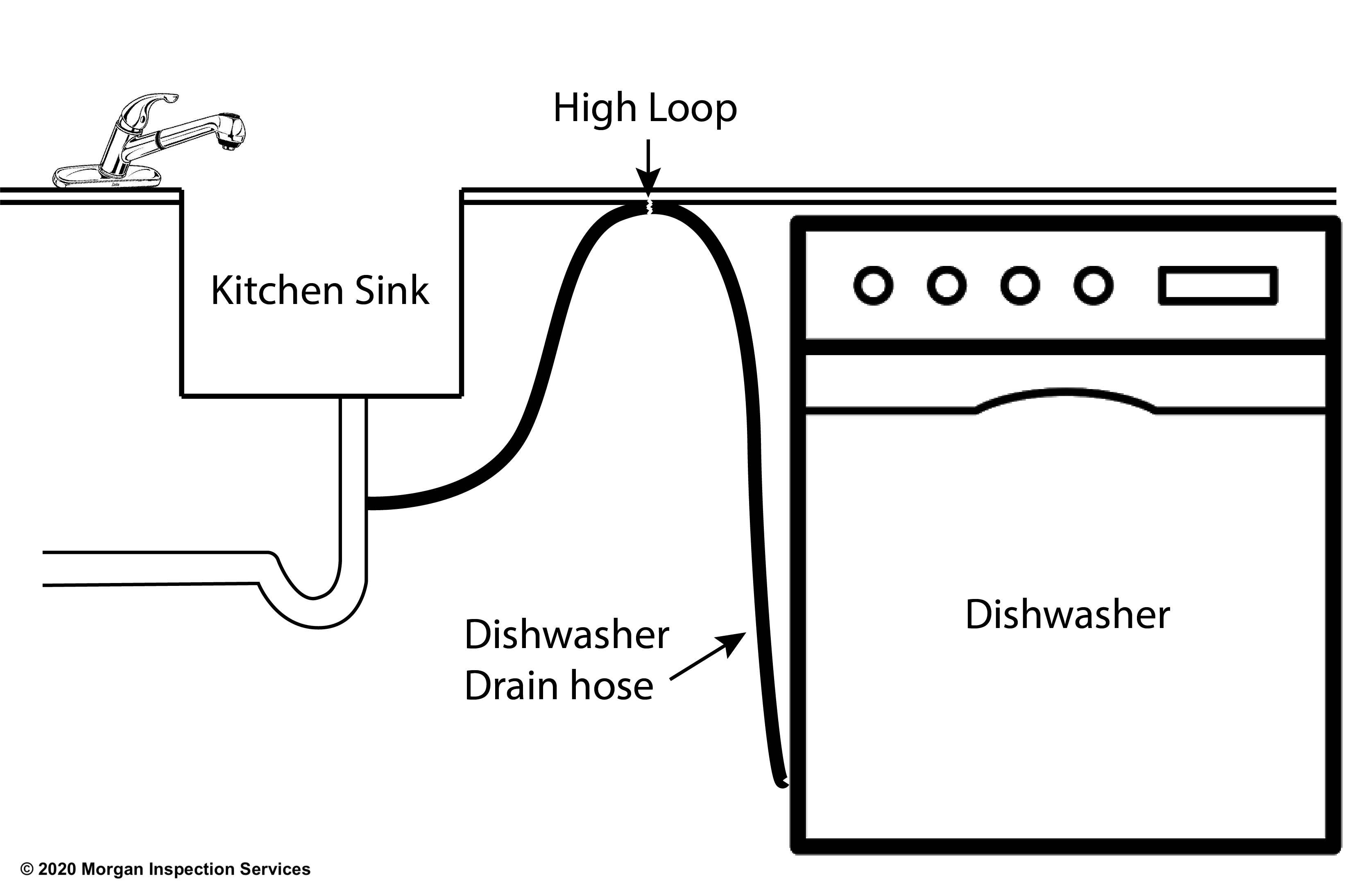

Don't understand your comment about the dishwasher having no pump. Dishwashers use a pump to circulate the water from the bottom interior pan, through the spray nozzles. The same pump is utilized to discharge dirty water to drain during each drain cycle.
The only way I could see a DW not utilizing a pump to discharge the drain water, would be a small chamber DW which sits on the counter top.
The best method to prevent the condition you are experiencing, will be to install a dishwasher drain air gap device as shown in the image below. The air gap device will be typically located behind the sink, located directly on the sink's rear apron, or directly through a solid surface counter when an undercounter sink is utilized.
With the air gap device, the dishwasher pump will pump the drain water into the device chamber which protrudes above the height of the counter top. Once there, the water will drain by gravity through a larger diameter hose which is connected to the disposal inlet or drain connection below the sink. Because the drain connection directly from the dishwasher is separated within the chamber above the height of the sink, even if a sink drain backup results in water overflowing onto the counter, no water will drain back into the dishwasher.
When an air gap drain device will not be utilized, most dishwasher installation instructions state to raise the DW drain hose as high-up and close to the underside of the counter top as possible (high loop) before lowering to the drain connection. In this manner, a sink backup will be less susceptible to drain back into the dishwasher, unless the water in the sink rises fully up to the level of the drain hose just below the counter top.
In addition, it appears your existing DW drain connection, is connected to the trap arm after the P-trap, whereas it should be connected above the P-trap, as depicted in your diagram.

It seems probable to me that there is a vent in the wall. Lack of a vent does not cause lack of draining; it causes smells.
So I suspect that you may have a clog. If you do serious piping changes, you should make it easier to remove clogs.
I sure don't like having those two glued 90s. I think one glued 45 at the wall, and the trap adapter glued to the 45, would have been the much better routing.
Minimally, I think the drain line should be snaked out. Then a new slip joint trap would be placed. The connection between the sink and the input to the trap would be a branch tailpiece. https://www.homedepot.com/p/Oatey-1...ailpiece-Plastic-Slip-Joint-HDC9698/315724875 The dishwasher hose would connect to the branch input to the tailpiece with one of the methods Bannerman suggested.
