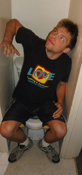

    That's pretty much the case with whatever you install. You can add 1.5" by getting a round bowl, but your knees will be in the same location regardless.
    If you have a wall heater on one side, you may want to move it out a ways from it. What you are mainly looking at is shoulder room. That's where your arms hang from.
    You need at least an 11.5" rough from the finished wall for the Ultramax II.

    Terry:
    Thank you for replying so quickly. Is that picture an actual installation?
    My concern is whether this toilet will fail a code regulation.
    Is the 21 inch clearance in front of the toilet rule mandatory? Is this toilet too large for this powder room, given the specs? (I already bought and received it from i-net purchase!)
    Should I measure 15 inches from the baseboard heat, and does this violate any rule regarding the toilet water supply line placement?

    That picture was from a hotel room in Eastern Washington. The space was so tight, that they hung the paper overhead. Your shoulders touched the walls on both sides. Legal? No.
    Are you having the new toilet inspected? Many of the old homes in Seattle are too small in that way too. I lived in one home where the master was framed at 48" and was 47" in the clear. I prefer something like 59" in the clear, but that's not what you have.
    [​IMG]
    Check it out, the toilet paper is above his head.
