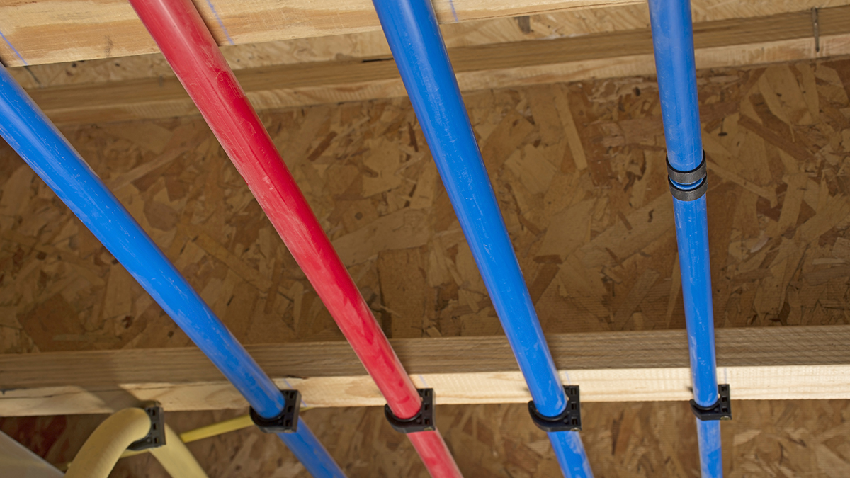

Any issues with the blue colored lines?
90% of my house has the clear colored lines with red/blue lettering…but the main 1” source into the house is the all blue PEX.
Wondering if I should be concerned :oops:
Tuttles Revenge
4,459
1,575
I haven't delved into the nitty gritty of this issue, but it appears that it was the process that Wirsbo chose to apply their pigment with heat or flame that possibly lead to this failure in Hot water lines. Likely the same process was used to apply the blue, but maybe hasn't been a problem on Cold lines.
Time will tell.
Maybe put a bucket with a battery powered moisture alarm under one of your main blue fittings to see if anything happens?
Johndoejohndoes
22
Florida
Time will tell.
It’s under the slab now. I wish I would have seen this post a few weeks ago since the slab was just poured.
Is Wirsbo different than Uponor AquaPex?
As you can see, most of the hookups going to everything is the white stuff. But the main run (into the white stuff) is a big blue line.
PS - Are those light “white scratches” concerning on the bottom of the blue line?
