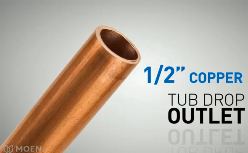

PEX has never worked for a tub spout.
The OD is the same as copper, but because of the thicker wall, it's a smaller interior dimension. Also the fittings further reduce the flow.
Using PEX to run to a tub spout forces water up to the shower head while filling the tub. All instructions mention this.
3,482
I think you can use 3/4" PEX, not sure... never have.
Once you've restricted for the 1/2" side of the fitting, I don't think so.
After you've tiled up and it's in the wall, it's too late to change it. I even had a showroom try to tell me it didn't matter. I guess they didn't like reading instructions. We plumbers need to though. I was the second plumber on the job making the correction. I removed the PEX and fittings, changed it out to copper and fixed it. We had to open up the wall behind it to make the changes.

Running PEX to the valve is fine. You can't have PEX to a tub spout.
The pipe that leads to the tub spout needs to be full size without restrictions or it will push water up to the shower head.

The objection to PEX on this thread is only between the valve and the spigot. I am pretty sure that you have never considered having polybutaline between the valve and the spigot.
If you wanted all F1960 PEX to avoid working with copper, this should overcome objections -- other than soldering copper is actually easier:
3,482
ANY restriction from the valve to the spout pushes water up to the shower head.
Once it's installed there is no way to fix it without tearing things out.
41,408
4,996
I think any restriction from the tee to the spout pushes water up the to the showerhead, but restriction before the tee will not.
3,482
The 1/2" side of the PEX fitting is a restriction. But go ahead, it's been tried before and it's failed. Let's put lots of stories of failed work here.
Removing tile and wall board to make repairs is fun.

Sorry folks, I think I'm derailing things here by not being clear. The above graphics and instructions are clear that I should not use anything other than copper between the valve and spout.
