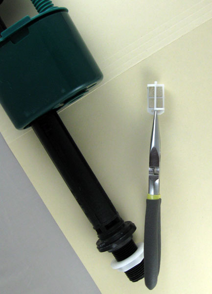

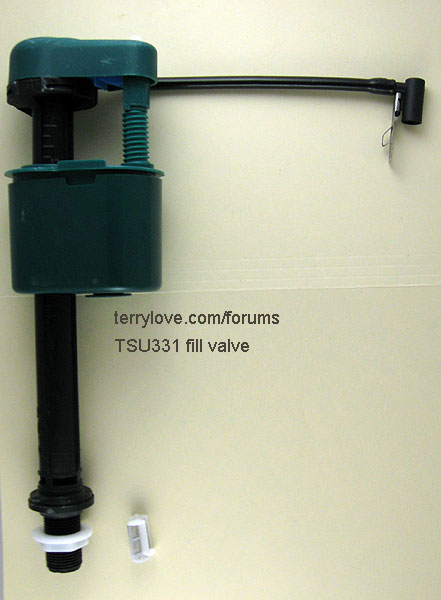

I was able to turn the water off at the meter with the key and replace the toilet supply valve with the quarter turn ball valve. The rubber gromet/washer in the old valve had broken into pieces, which is probably why it wasn't shutting off all the way. I figured that might have been blocking the flow and the reason the toilet was filling slowly, so I reconnected the toilet but still had the same problem with slow filling. I removed the tank fill valve to look for that little screen Terry showed in the picture above, and I can't seem to find one. The valve in that picture is certainly somewhat different than mine though. I turned on the water supply while it was disconnected to check the flow, and there is definitely good pressure, so it seems everything is good up to the tank fill valve. Is there something I'm missing here, or should I just replace the fill valve?
41,408
4,996
If you call Toto, they may send you one free.
When you say good pressure, I presume you mean good flow.
