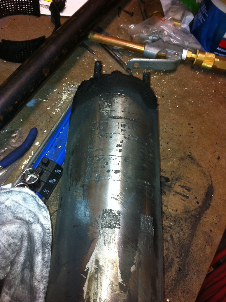

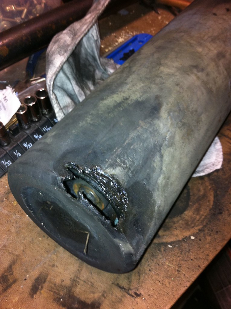

I have a 1hp 2-wire 240V submersible 4" pump installed in a PVC-cased 6" well. It was installed 6yrs ago. The original pump/motor was a red jacket grizzly with Franklin motor. After 3yrs it failed (locked rotor) and when I pulled it out the case was visibly corroded with holes in it. The pump itself looked fine
3 year old well pump motor case corroded so badly it seized up?

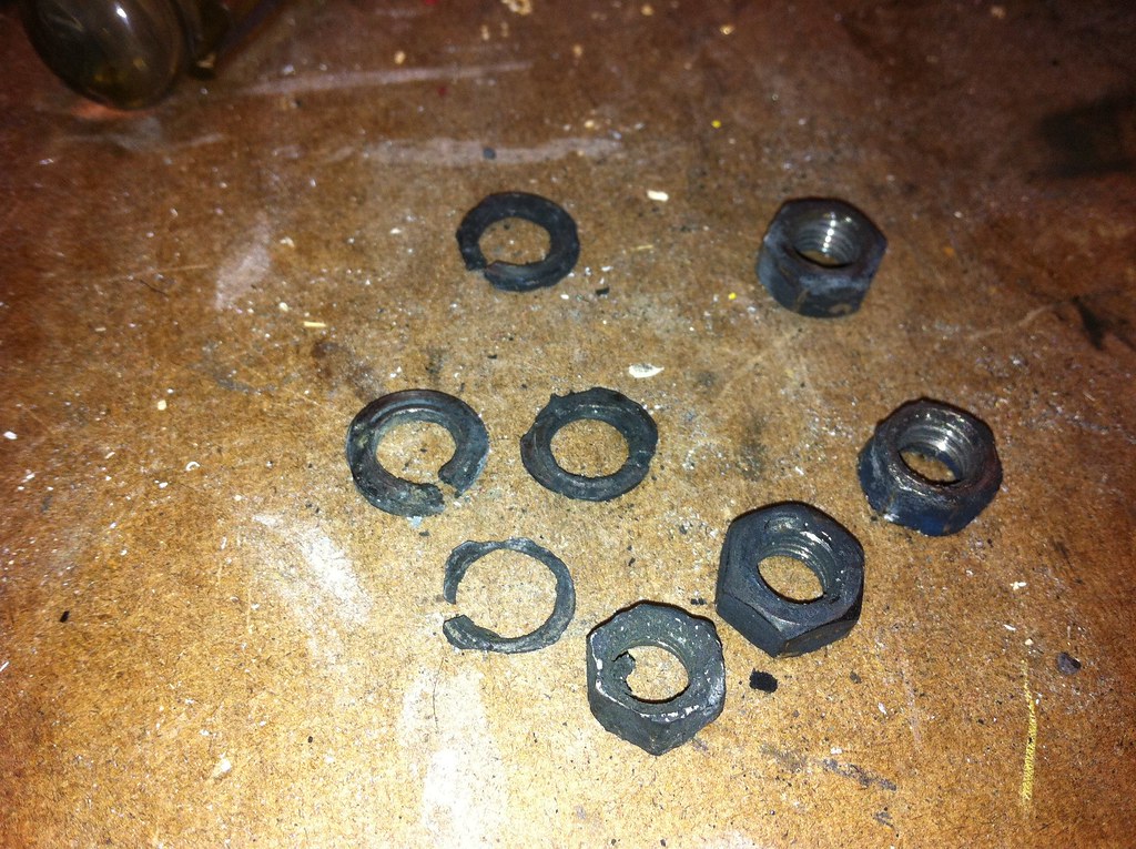

I replaced the Franklin with a same-sized Grundfos which operated fine until I turned it on last weekend for the first time since winter. No water. I pulled it out and it also had a locked rotor and the same case corrosion.
3yr old SS pump motor corroded AGAIN
The well is connected to a lawn irrigation system and has plenty of sulfur that you can smell and see the residue. I measured the pH at the top of the water table and it was 7.3.
After seeing pics of the corrosion the pump guys thought this should be posted in an Electrical forum as well.
I really really really need to keep this from happening again.
Pics of the 3-yr-old failed Grundfos:

Actually I sent the guy over here because he mentioned some large pad mounted transformers 100' from his well. I thought this might take us back to current leaks.
I see a lightening strike in that pump hole, but now he has mentioned that the water is only for irrigation and stinks highly of sulphur.
Also he has no pressure switch or tank on the rig, so it might be running dry. Add a low pressure cut-out switch and small pressure tank. And a buried ground mat at the well top might be advised. The new so called 'three wire pumps' pumps have 4 wires, one for starting, 2 for running, and a dedicated ground wire.
As to small wiring, Franklin motors thrive on wires far undersized by an electricians gauge chart. Franklins own charts advises these wire runs because it provides a 'soft start' and the motor is wound for this very type of service. These are not motors like on your table saw!
Any doubts, search for 'franklin AIM manual'
OK on edit: I see the 'new pics' of the pump head that looks fresh and clean.
So now I say forget the sulphur and focus on the stray current issue.
Unless Franklin uses junk SS, which has not been the case. This seems a grounding issue.
I say get out your equipotential bonding grid thinking caps again.
Undersize wires DO NOT burn holes in franklin motors.

I agree with what looks like lightning damage but I also think there may be stray currents flowing down through the ground wire. It would have been interesting to have put an ammeter on the ground wire before the pump was pulled.
I would inspect the service for a poor neutral and/or poor ground.

I do not think he has showed us a picture of the used pump HEAD. Is it like the motor? Those appear to be from a old thread.
The new motor will have a ground wire and he should be very serious about using it correctly.

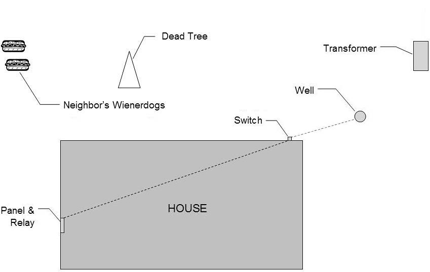

I cross-posted this to another electrical forum here: http://www.************.com/forum/electrical-c-d-c/447687-submersible-pump-motor-keeps-failing.html
Per the advice from one of those guys I'm going to out the pump back into the water and take measurements at the ground.
The shiny pics of the pump head are from 3yrs ago but it still loons the same. No evidence of corrosion.
The wires to the pump are 12AWG.
The electrical box is more like 25-30ft from the well. I have a rough sketch in the ************ thread.
FWIW the pump is about 85ft deep and when they drilled they said they hit water at less than 40 feet and with the test pump had tons of flow. That was 6yrs ago.
My well gets much less use that many of my neighbors who sprinkle 3-4x per day every day (mine is more like once every 2 to 5 depending on weather).
Will report back.

OK, I lied about the distance. The well is more like 15-20ft from the transformer box.
I checked resistance from the ground wire to the motor case (from the end of the motor pigtail) and there was only about 2ohms. Which makes sense because the ground is actually screwed to the case. (Somebody asked this question in one of the threads I think).
The pump/motor is back in the well and I will check the ground ASAP.
