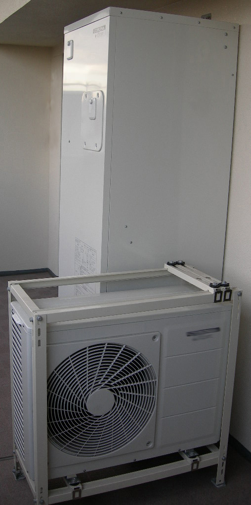

SANCO₂ Water Heater, Generation 4, imported from Japan.
The taller the tank, the better the COP.
The refrigerant is sealed, so no greenhouse gas leaks, ever.
Expensive, but just due to low volume of sales in the USA. Very common in Japan,
where there are a dozen models, all called Eco Cute or Mini Cute or something like that.
The SANCO₂ product is the North American version of the Eco Cute Water Heater that was first introduced into the Japanese market in the summer of 2001.
The name of the EcoCute comes from the Japanese phrase Shizen Reibai Hīto Ponpu Kyūtō-ki (自然冷媒ヒートポンプ給湯機), which literally means "natural refrigerant heat pump water heater".[1] Eco is a contraction of either ecology or economical and Cute is a near homonym to kyūtō (給湯); literally "supply hot water".[2]
