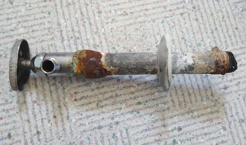

New PEX is going to deliver vastly larger volumes of water compared to an old rusty galvanized line even with a moderate reduction in fitting volume. Once you cut out a single 12" piece of galvy and try to look through it end to end you will see why.

So I had a great local plumber replace galvanized with PEX five years ago. All the pipes they cut out were filled with corrosion like in Tuttle's photo. We chose to route the PEX like the old galvanized pipes.
