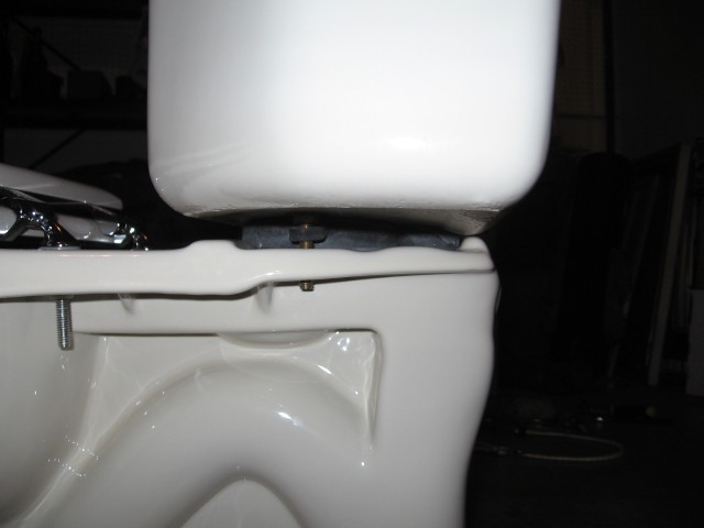

I'm trying to install a vacuity toilet. On the back of the bowl there is a raised "bar", such that the tank, when tightened down completely, is not level. It leans forward.
If I can manage to insert this image, here is what it looks like from the side:
https://terrylove.com/forums/attachment.php?attachmentid=356&stc=1

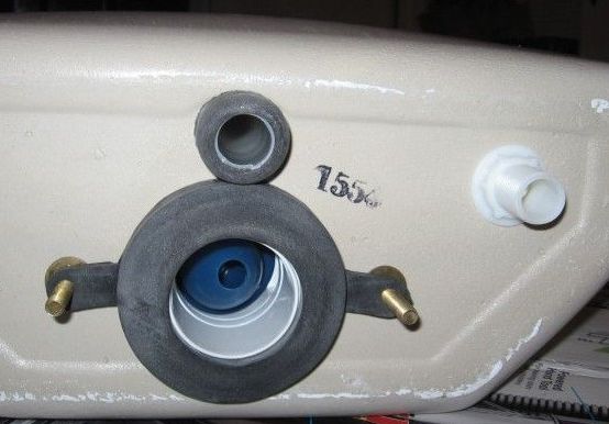

The tank is already resting on the "bar" even before tightening:
https://terrylove.com/forums/attachment.php?attachmentid=357&stc=1

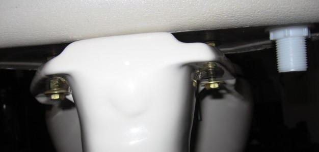

Here's the bottom of the tank:
attachment.php
When I tighten the tank bolts, the larger foam seal gets compressed and I've got the leaning toilet of Pisa. If I don't tighten it that much, it leaks. Any suggestions? I've been thinking of trying to grind down the bar on the back of the bowl a few mm, but I'm not sure how to (or if I can) do that.
Thanks a bunch!

I would say it is 5-8 degrees. It is enough that it is obviously leaning out from the wall when installed. But it isn't so bad that the seat won't stay up.
Thanks again for your advice.
Mike Carney
Glenwood, Iowa
I have installed a number of these toilets and found that I could tighten the bolts enough to make the entire tank level and this compressed and sealed the gaskets sufficiently. I suspect Briggs designed the lip to keep us from cranking down the seals too far! :)
