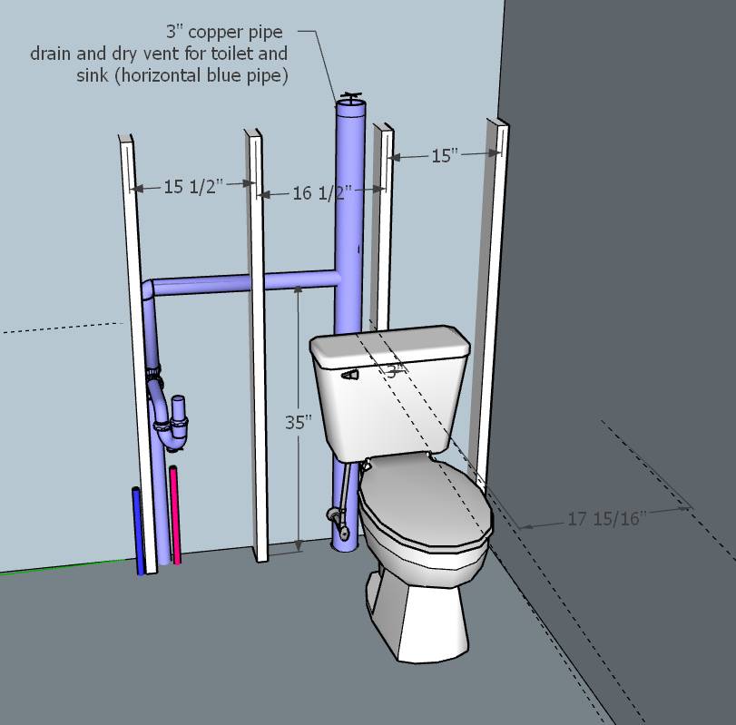

Here are the dimensions measured after I opened the wall.
here is a previous thread that adds some context
Before opening the wall I made my peace with the idea that I will be installing a normal toilet because:
-I thought the wall is built with 2x4 studs (but no, it is built with 2x5")
-I thought that in order to reach the main stack (drain) I would need to go through a stud with would have been difficult with a carrier installed there and a 2x4" carrier
I am now seeing that:
-the wall is made using 2x5"s
-the drain is next to the toilet (as you can see it is a 3" offset)
I would prefer not to move the toilet to align it with the drain, if that is an option

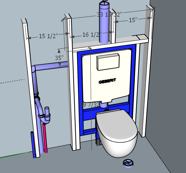

Question marks:
-is it possible to connect the toilet with a T like fitting to still use the existing vent (that goes to the roof)

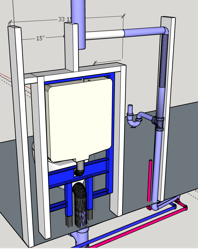

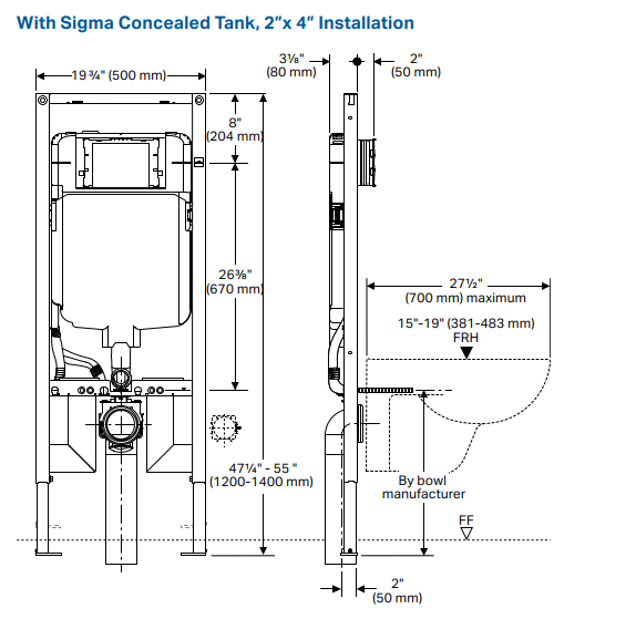

-is it acceptable to create adequate framing there to support the carrier (thinking about cutting the second from right to left stud and rebuild a frame there. Like so

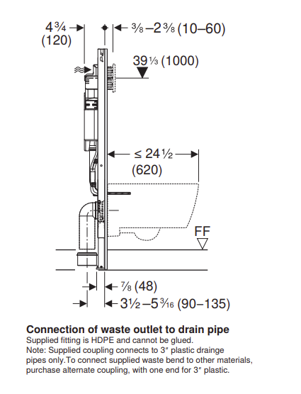

-What do you guys use to transition from the toilet (ABS or PVC?) to the copper of the drain ?
-since I would have to probably relocate that horizontal dry vent for the sink and reconnect it to the main drain/dry vent I am thinking going ABS from the toilet T up to above the point where I would relocate the horizontal vent and then transition back to 3" copper using one of these flex couplings
I guess the biggest question mark is that T that connencts the toilet to the cupper drain (downward) and upward to more ABS pipe)
Update: here is a zoom in into what is behind the carrier
