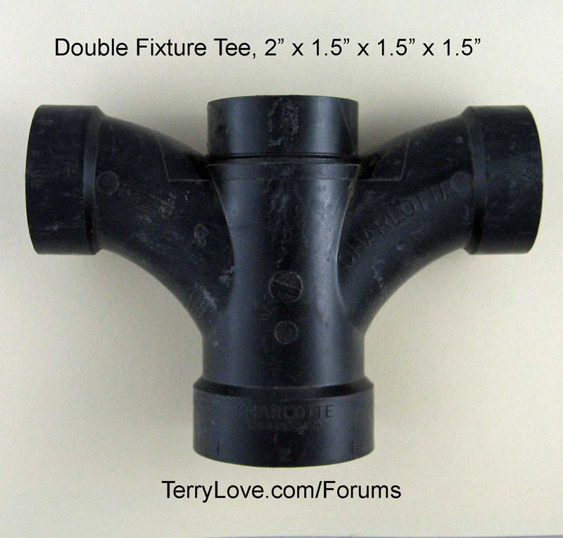

Hello, we do not like the plumbing solution that has been put in place for two sinks in our newly constructed master bathroom.
these are image while looking at the plumbing from the "back" . These are delivery lines and drainage for two sinks with wall mounted faucets:
I would appreciate comments: is this install to code? I am in CT. Are there possible troubles that such installation may cause? (our concerns are mainly with so many connections and "dead ends" on delivery lines just asking for leaks) . I would have imagined that the drainage should go straight down and for some reason it goes "vertically" almost, but..... we are lame homeowners and not plumbers.

You have the wrong fitting for the cross.
It should be a fixture cross, not a wye cross. The wye cross creates an S trap.
The waste where the two meet should me minimum of 2".
If that is all done in 1.5", it doesn't meet code.

Oh, good catch Terry, I totally missed the double wye... that definitely needs to be replaced. As for the pipe, is that not 2"? It looks like 2" with 1.5" trap arms, but hard to tell for sure from the pic.
Whoever put that in thinks they're working with copper and that they need fittings every time the pipe bends. They probably have never worked with Pex before to do it like that, so I'd question if they really knew what they were doing to do it that way. Properly installed, there should usually be NO fittings between the connection to the main lines/manifold (in the basement or utility room or wherever they're coming from) and the connection to the copper stub-outs mounted to the wall for the wall mount faucets. Sometimes if you have to make a tight turn you'd use an elbow, but otherwise, there's no need for fittings between those two points. It is fairly important to minimize fittings in a Pex system to keep the flow rates adequate.
I'd certainly have those lines ripped out and replaced. And I'd probably get a new plumber to run them that's more experienced with Pex. Also, have that double wye taken out. Given that problem, I'd suggest you have another pro look over all the work this plumber did. Any pro should know that you can't use a wye to tie a trap arm into the drain...
Depending on what all is coming up on those other 2 vent lines, your 2" vent going up from where the 3 vents tie together might need to go up to a 3" vent as well. We can't tell that from these pictures though.

And taking another closer look... I see that there's a bushing in the vent line, reducing it from 2" down to 1.5" going up out of the room. There's no way that's gonna cut it. It needs to be a 2", if not 3" (see above post) line coming up from that double santee fitting.

it's level, unsloped, in a trap arm. One or both.
From what I can make out by seeing the photo, the arm needs a 1/4" slope which is missing. Without the slope your pipe collects a lot more gunk than with the slope. Then it drains slowly.
When the cross gets cut out and replaced this too is good to check.

For the vent, the double combo, (not a double san tee/cross), MUST be inverted. It would still not have been correct, but the double combo would have been a better fit for where the two drains meet and use the double "Y" and 1/8 bends for the vent. The wires are the proper distance from the surface so they do NOT need nail plates. I have NEVER used "squares" of metal as nail plates for my plumbing, but if I did, I would center them on the stud so they protected the pipe against "misnailing" on either side of the stud.

The big thing is the one thing about the fixture cross.
So what if the inspector overlooked it.
If you left it, you would have all the potential and real problems of S traps.
S traps: sometimes it's serious, sometimes it's not.
Why not get a more reliable drain system now?

Often inspectors are plumbers who could not make it as plumbers so they get government jobs where they may NOT have to be competent. That "double fitting" is, and always has been, improper and illegal. Call the inspector and ask him if he missed it, so that he can reject it and have the installer replace it. If not, then get a "real" plumber to do it. The water piping is NOT illegal, just "shoddy workmanship" but if you get another plumber I would have him clean it up. It only has to be done in that room, NOT from the first floor up. I know a lot of plumbers who have "valid licenses" but would NEVER recommend them to ANY ONE.
