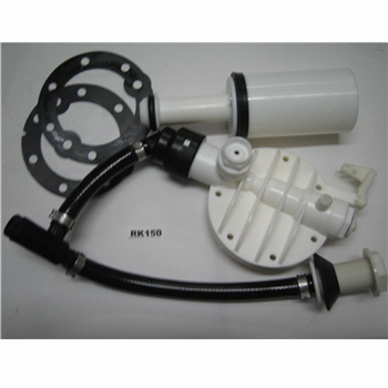

I have 2 Elger PF2 toilets. One of them was nothing but trouble starting about 6 months after installation. I had to constantly take out the little red ball, clean it & reinstall it to get a good flush. The other never gave me issues until recently. It started leaking from the water supply stub where the braided supply line connects to. I have removed it, and replaced the inside gasket numerous times, but even after putting teflon tape on the threads and flange it still leaks. I have also replaced my braided supply line, so that's not it. It leaks right where the stub comes out of the bottom of the tank. Also, is it normal for there to be water in the tank? There is usually about an inch of water in it.
Does anyone know where I can get JUST the black supply line/threaded inlet/nut/gasket that can be seen in the RK 150 kit (bottom right corner of pic below)? I don't need anything else from this kit, and I can't see paying so much money for the entire kit. I'll replace the toilet before I do that. $120 seems a bit steep for a couple of gaskets, hose, plastic and cartridge when you can buy a descent new toilet for a few bucks more
