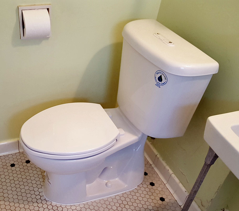

Caroma Sydney Smart 305
I don't know who is selling these nation wide. I've been selling in the Seattle area and Whistler Mountain has them in Canada.
