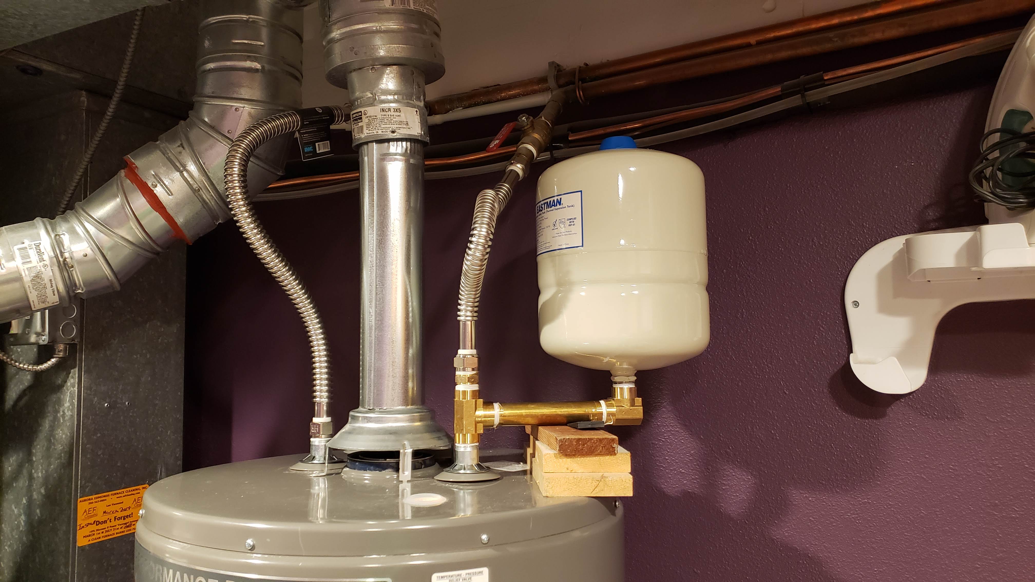

Hello all. New here but have been picking up some tips and thought I would make a post. I am replacing a 17 year old gas water heater and it seems pretty straightforward. I have done a couple of electric ones before so the gas is really the main difference. I am likely going to get the Rheem 12 year 50 gallon tank at Home Depot. My other local option is A O Smith at Lowes but they just have the 9 year in stock and the Rheem has a brass drain so maybe it is higher quality. It is about the same height as the current one so I should be able to put it right in place and connect the exhaust to the current setup. Actually, the current tank sits about 5 inches away from the wall and if I push it back a couple, it would line up perfectly without needing that bend in the pipe. It currently has flexible copper lines from the solid plumbing to the tank which I will replace. Do you recommend the corrugated stainless lines (not braided) over the copper? I will also replace the gas line as well. I suppose I should put this in a pan (even though in the basement) and I will need to strap it to the wall.
There currently is no expansion tank and I want to install one without soldering or modifying any of the existing solid plumbing. I know I will have to put a tee either on top of the tank or coming off of that shutoff from the cold line. Will it work fine to just get an expansion tank bracket, mount it to the wall, and run another one of those flexible lines from the tank to the tee? Any other better ideas, let me know. Thank you.

Anyways, I just went to buy the tank and expansion tank and they did not have any brackets so I ran my idea past the guy at the store. He told me he has always just run a tee off the tank with a short piece of pipe and a 90 with tank screwed into it (like in the image below). I have seen all kinds of setups like this when I search online so that seems pretty common. I don't like the idea of it being fully supported by the pipe though in case it fails, so if I just put a small block of wood or something between the horizontal pipe and tank to support the weight, will this be a good setup? He told me to get galvanized pipe so I picked that up too. Is that going to be fine or is brass better? After doing some research when I got home, I am confused as to whether you can mix galvanized and brass/copper so now I don't know if this is right. I plan to either connect using the copper or stainless corrugated pipes. Thank you.

Ok maybe I will go back and get brass then. So do you think that setup with a brass line off of the tee as shown about but with a block under it to support the weight better than mounting on the wall with a flex line? Is that how you would do it?

Ok, I have the brass fittings and will do it the way you show in that picture, Terry. The guy at the other store I just went to suggested that too. He also said a 2 gallon is adequate for a 50 gallon tank and then it wouldn't be as heavy, but said putting a block of wood under the pipe to support it will be fine too. Should I just stick with the 5 gallon? Thanks for all of your help.

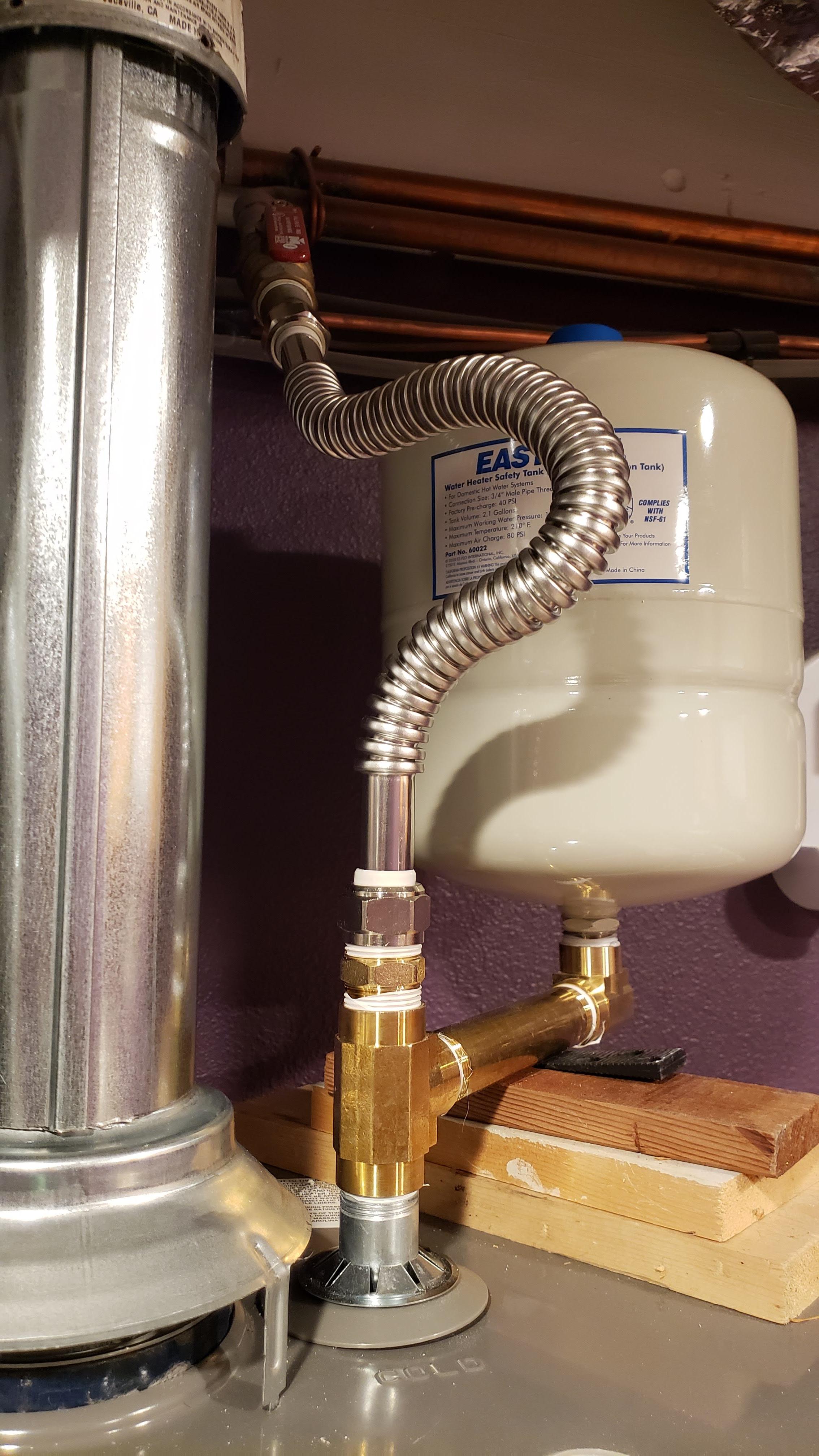

Just thought I'd report back here. I got it all set up last night and it works fine! I do have some small drips in the brass fittings though so I am going to take it apart today and use pipe dope instead of the teflon tape and hope that seals it up. Other than that, all seems well. Thanks for all of the help.
1,193
Many of those hose fittings have a gasket in them...using PTFE tape will often CAUSE a leak. The tapered pipe joints, though, do need tape or dope (some use both). FWIW, it's not Teflon (Dupont owns that name, and does sell or make the plumbing tape stuff, it's the generic PTFE material, essentially the same, but not correct to call it Teflon, just like not all tissues are Kleenex).
