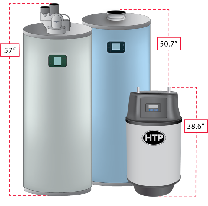

I was considering a 200k tankless because it was the largest I was seeing locally. We only have 1 nice shower today so there are never situations with multiple simultaneous showers or baths, there is almost constant laundry or dishes with 4 females in the house. I might redo a bathroom in the future to add a second shower but that’s at least a couple years out.
As for venting, I do have clearances for a powered vent direct vent, just not a power vent. From reading the install guides I’ve gotta stay at least 12” from my openable windows with power direct which is possible, it’s the 4’ from openable windows with the standard power vent I can’t meet.
All the hybrid models I see listed are electric. You have me intrigued by this 20gal gas hybrid? Who makes those?
Made by htp. I love mine and I don’t remember the model I got but you can usually use the same 1/2” gas line. Mine may have been a 75,000 btu.
