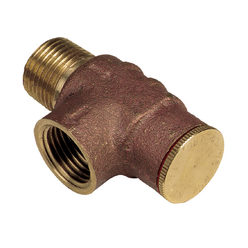

Are there other alternatives? One idea is a pressure blow off valve right after the foot valve. This way I could add a string line and pull it open to drain.

Another idea would be to tee the foot valve to a pressure relief valve. So when you compress to 75 psi, the relief opens to let out water and/or air.
You could use a standard pressure relief valve without a pull string. You just need to supply air pressure that is higher than the pop-off pressure.
Interesting. I'm in Canada and most of the pressure relief valves are for air compressors rated at 125 PSI. It also seems like the orifices are tiny (>.25"). Do you have a link to a product sold in the US or Canada which would work here?
