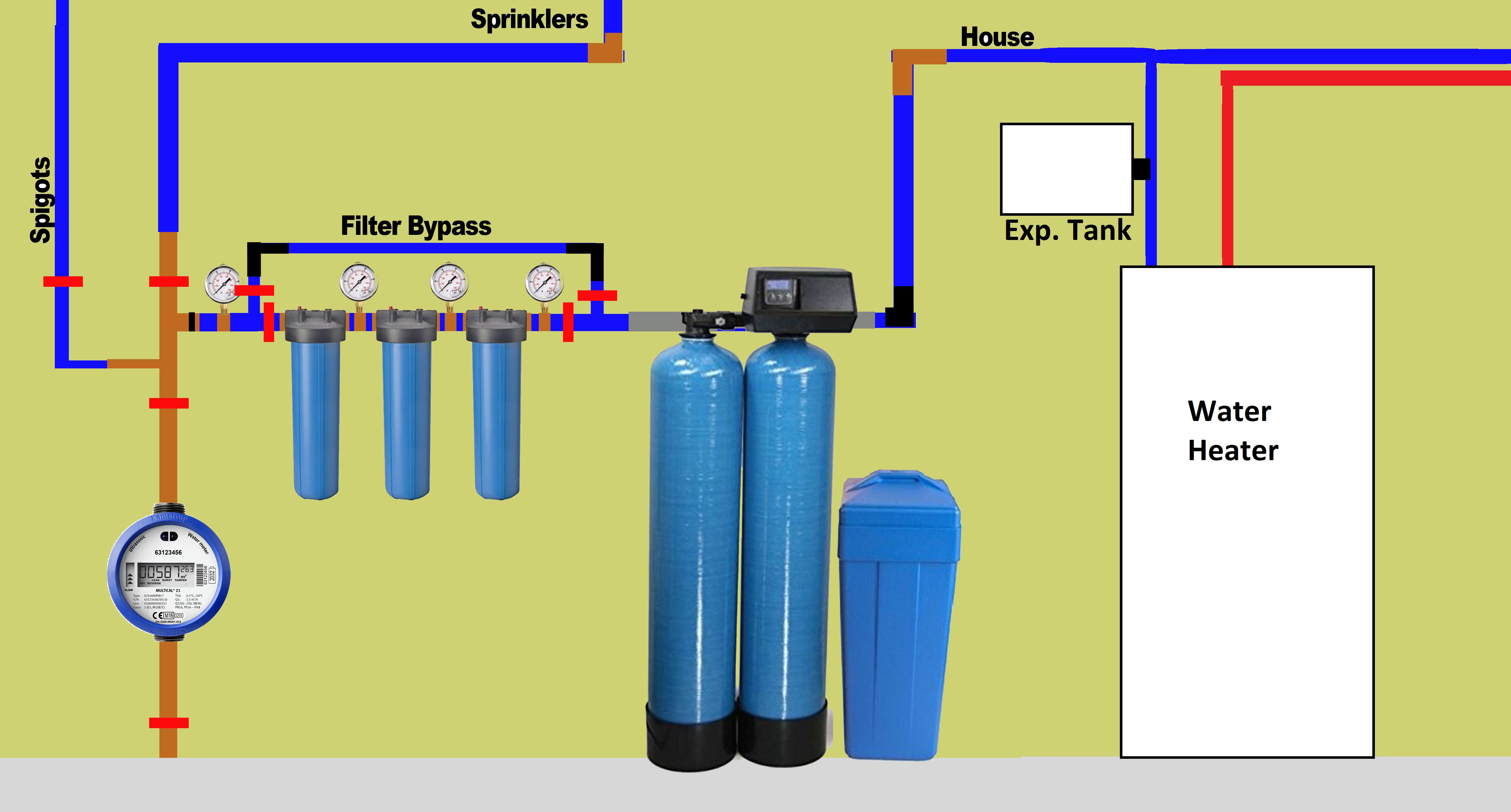

I have a Fleck 9100SXT Metered Dual Tank Softener - 64,000 Grain per tank. The water flow indicator(water drop) is intermittently blinking and showing flow(roughly shows flow for about 5s every 2 minutes).
Entering the FR menu, the flow varies from 0.1 -0.3, again always lasting no more than a few seconds. This is where things start to get interesting, when I cross checked the water meter on my house, it did not show any flow. This leaves me with a couple of theories:
1. The "flow" is so low, that it's not actually pulling any water from the water main, thus the softener detects the flow, but the meter does not.
2. The softener is malfunctioning in some manner and detecting flow when there isn't any.
Theory 1 does not seem to be likely given the FR rate indicated, I would expect to see some change on the water meter for the house.
To test theory 2, I placed the softener in bypass and it stopped showing water flow. I then placed the softener back into normal operation, and turned off water to the various items that may call for it(water heater, ice maker, etc.). After ~2 hours, the usage had "used" 2 gallons of water.
I'm not sure where to go from here. But I am stumped.

I actually have pressure gauges inline. I drafted this as an outline. All gauges look in normal range.

Nice diagram of a nice system.
I am at a loss to explain things. Here is the closest scenario I can think of at the moment, other than a flaky turbine meter. For reasons unknown, there are small pressure fluctuations on your city water pressure. They are too small to observe on the gauges. These pulse through the to the pressure tank. Now that scenario presumes there is not an effective check valve at the meter, because otherwise the check valve would isolate the fluctuations when you are not using water.
If that is the case, you could remove the thermal expansion tank. You would see that the water pressure did not rise after a hot shower as you would expect with a working check valve on the incoming water.
So just to be clear, I am only pondering. I am not saying that I have any experience along these lines.

Is a check valve located where the water service enters the home? Is there any air trapped within the fire suppression system (sprinklers)?
Without a check valve to isolate the main line, water being heated will expand and will flow back into the municipal system or further compress air within the sprinkler system.
Although you installed an expansion tank on the water heater inlet, without locating a check valve between that expansion tank, the main feed and sprinkler system, any expansion that does occur will flow to the expansion tank, the sprinkler system and municipal service until pressure is equalized between them all. A check valve directly after the softener would confine the water heater thermal expansion to the expansion tank just installed and would not expose the softener to increased pressure occurring in the expansion tank.

So did some more testing, and unfortunately now I'm even more confused.
1. Removed Magnet Sensor from Softener - Result: Flow Indicator stopped(as expected).
2. Turned off inlet to softener - Result: Flow indicator stopped.
3. Turned off every ball valve on inlet side(one by one going back towards the main). - Result: Flow indicator stopped every single time.
4. Turned off the outlet on the softener - Result: Flow indicator stopped.
My current thoughts is there a pressure differential on the main side. Therefore, I should place the dual check valve on the inlet side after the filters, but before the softener.
Any thoughts?
