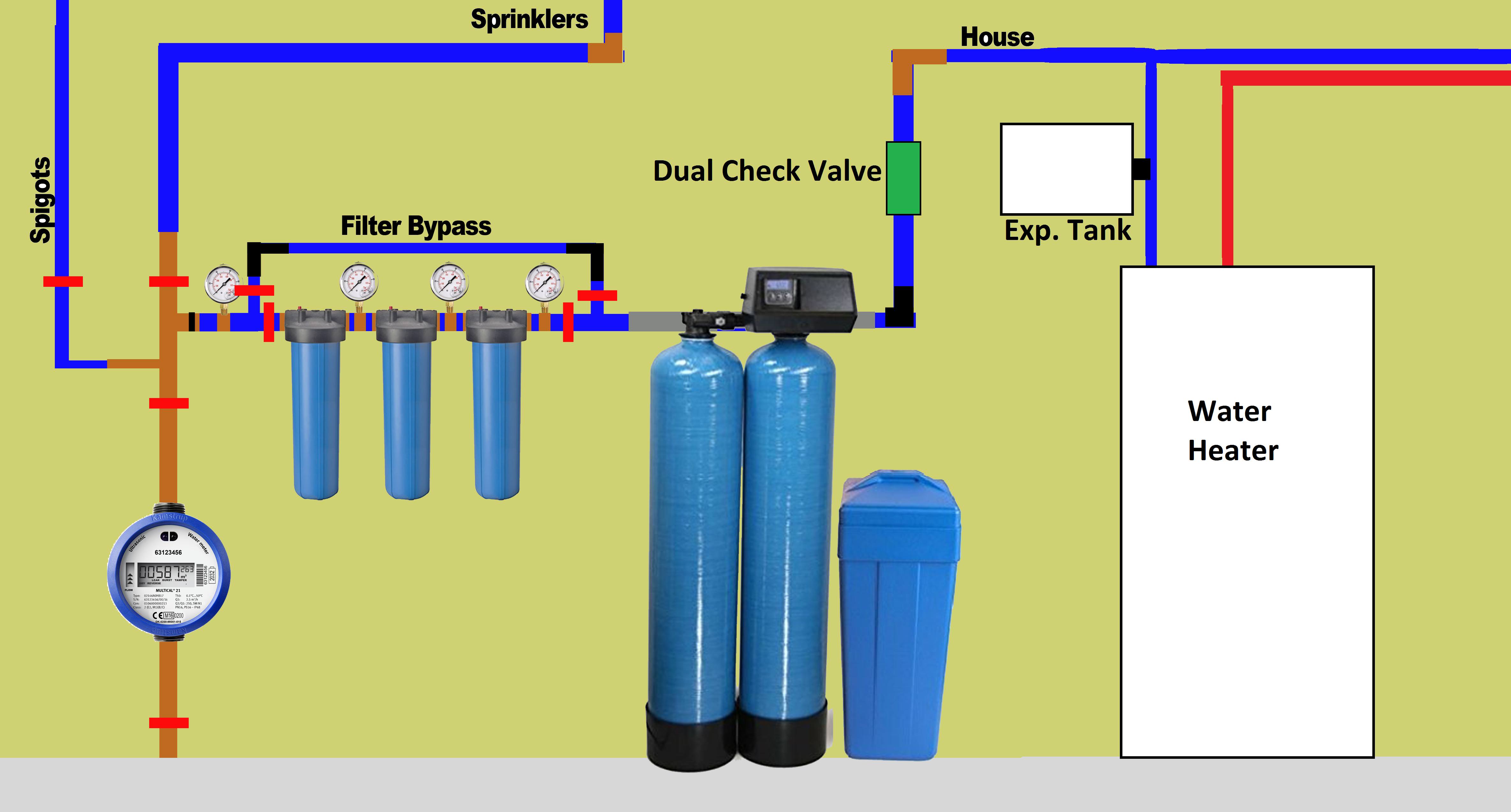

Simple solution.. this is a very common problem.
As the water heats it expands, the "extra" water has to go somewhere, so back into the city supply it goes. A thermal expansion tank wont do anything to prevent this water movement. A thermal expansion tank is used to absorb the extra water when the house has a check valve or backflow preventer. Install a spring loaded check valve on the outlet of the softener, this will usually correct the problem.
The meter is on the outlet of the softener and since it is a hall effect turbine, water flow direction does not matter, it will read in either direction.

This is my current plan, currently I am planning to use a dual spring loaded check valve on the outlet of the softener. I'm assuming this will keep any expansion from the hot water tank from pushing back and engaging the hall effect.
Regarding the comment about this being a very common problem, every company I've talked to has been at a loss, including various softener companies.
However, one comment you made has me slightly confused, in my current design what is my expansion tank doing if anything? Since I have no check valve currently, is the expansion tank effectively not doing anything?

No, IMO. Oddly enough, I think it is contributing to your problem.
If you are electronics oriented, think of it as a capacitor. That forms part of the path of a metaphorical AC current coming in from the city pipe. Your turbine is acting as a recording AC milliammeter.

The expansion tank pressure will be currently the same pressure as the municipal water system, often 60 psi.
The expanding water within the water heater will need to go somewhere, but water will always take the path of least resistance. The expanding water will not, therefore, flow into the expansion tank as that will increase pressure higher than the municipal supply pressure, but there will be less resistance back through the softener to the water supply main.
The check valve after the softener will prevent backflow through the softener, so the only place the expanded water can be absorbed will be into the expansion tank.

Interesting insight, I didn't even consider the expansion tank to be equal to(or more) than the city main. This in theory would support the idea that it is flowing in the wrong direction.
Sounds like the dual check valve is the way to go. Not sure I'll get to it this weekend, but I'll update once I complete it.

Double checks were a code cheater that is no longer allowed in place of a backflow preventer. A standard single check should be just fine.
And the other companies you talked to probably lack the field experience that only a few people in this industry have. I personally have worked the field for 30 years with the majority of that being in the commercial and industrial market. The installation of a check valve without a thermal expansion tank is a sure fire way to test the P&T valve. As stated, the thermal expansion tank will have no affect since the very slight increase in water pressure is shared across the entire plumbing system. When you install a check valve you have isolated your water heater plumbing from the community plumbing system.
The flow of water back and forth across the meter usually only makes a tiny amount of water. It rarely affects the systems efficiency. You may only notice a gallon of water change in the meter over the time of an hour.

Torque has a very unusual situation. His usage indicator flashes even though he has not been using hot water. The indicator stops flashing if he closes the valve in series with the water meter. While that could happen as the water in the WH heats after hot use, his appears to be more persistent than could be explained with the normal stuff.
I think he gets an alternating pressure component on top of his steady state pressure.
We all agree that a single spring loaded check valve on the output of his softener, and keeping the thermal expansion tank, will solve this whatever the cause.

To be clear, I will be placing the dual check valve only on the outlet side of the softener, prior to expansion tank.
Appreciate the help from everyone, I will keep you all posted.
Torque
MI
So my plan is to install the dual check valve post softener before the water line tee's off to the expansion tank and the rest of the house. It is pictured in green. Please let me know if you all are in alignment.

We are, but your green rectangle needs the arrow. Or maybe two arrows in series in your case. :D

Good news everyone! I put on my magnetic balance bracelet and was able to resolve the issue. Putting in the dual check valve has solved the issue.
