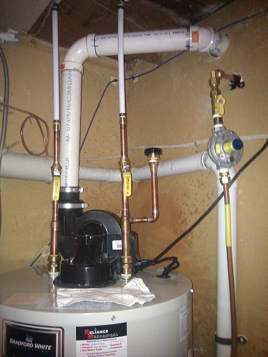

Here's the power vent fan located outside the house. Again there is nothing obstructing this vent path, I might have a thought that there might be too much headloss in this setup for pilot exhaust to vent (when the fan is off). Any thoughts?

That unit is way older than 11 years unless someone rigged up something... They discontinued
metal pipe on power vented heaters probably back around 1993..... It will not ever work correctly...
because it is way too old to rig up pressure switches to and throw tons of time and money at....
the cheapest thing your tight assed landlord can do is just totally tear it all out then run a 220 volt
power line to that area and install a 50 gallon electric water heater..... that is it...
if push comes to shove wait a while then throw a quart of water down into the top of the heater flu pipe
and just tell them that the unit has begun leaking... THEN something will finally happen one way
or another
