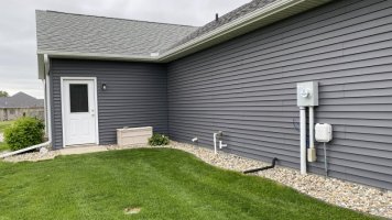

I have a Bradford White Defender hot water heater with power vent RG1PV50S6N. The physical L shape of our house walls catches nasty backdrafts that go up the 45 degree angle exhaust pipe and down into our basement where the hwh is located. This happened with our bathroom vent too in the soffit above and we put a backdraft preventer on that.
Is there anything outside at all I can do with the termination point to help? You can see my walls and vent attached. It is close to the ground.
I've been told by a few plumbers I should NOT do the "candy cane" type connection where the pipe comes out (seen below), goes up and then down 90 degrees because of possible condensation issues. It's confusing to me because they start talking about my system probably wouldn't do that but if it did there would be acid and that needs a separate drain, etc.
I can't install a damper on the pipe inside myself and would be a bit scared to go that route because if it ever fails or gets stuck, burnoff could backup. In theory the Bradford White shuts off if that happens, but that "in theory" could get me killed.
We looked at something like this from Amazon to expand to a 3 inch vent, but it would be frankensteined together outside to make it work. https://a.co/d/dCJVn7q
I asked Bradford White and they said there is nothing I can do because my exhaust doesn't go through the roof.
I guess if there is no outside solution, if there was an inside damper that could go in the pipe with an indicator about it opening correctly it would give me piece of mind.

OK, thinking about abandoning the outside solution and installing a PVC damper in the horizontal 2" pipe (inside in the basement) that runs outside. What do you think of that idea?
I don't suppose the damper could freeze closed could it?
I just called Bradford White and they said there should be no way I am getting any backdraft. But they also said I should not install a damper.
Is there anything I can do to prevent this outside air coming in?

Was there something specific I missed there about preventing backdraft? I have the manual and referenced it in my original post in the small diagram.
I have the 45 degree angle termination point. Even if I did the other "candy cane" type termination configuration it would not prevent backdraft because the soffit vent for my bathroom fan had to have a damper installed the wind pressure was so strong.
I think the only possible solution is a damper in the horizontal pipe just inside the basement foundation wall, but it seems like Bradford White is cautioning against it, so far without reasoning why. Waiting to hear from them. It's hard to tell if they just don't want to talk about anything related to exhaust for liability reasons or if that truly is a bad idea.
They show a 90 degree bend pointing down. You have a 45 or 22.5.
Logically 45 would seem to be more prone to being affected by winds than a 90. How about adding a 45 to what you have?
But that might run afoul of the snow thing.
I have an idea: do the page 17 thing, but drill a 3/8 inch hole to drain water from the low point.

I don't think you are supposed to have a 90 degree termination that close to the ground. The concern is snow level. Plus 90 degress won't stop the backdraft. It's a wind thing but also likely a pressure situation.
Master Plumber Mark
5,905
519
www.weilhammerplumbing.com
Just throw another 45 on that line and point it down towards the ground....
maybe put a short nipple into the end and extend it downwards aabout 4 inches
I would not worry too much about snow and you can always keep an eye on it
you wont have a condensation problem and if you look on top of
your heater on the side of the fan motor their should be a drain port that you
just pull the cap off of and throw a piece of tubing onto and drain down to the
floor
it will work

Sorry, not a plumber. I get the part about another 45 degree angle pipe. Can you explain "put a short nipple into the end and extend it downwards about 4 inches" to me? Do you mean a part with two male ends to connect the two 45 degree angle pieces? The current 45 degree angle piece has no threads and is unfortunately glued on close to the wall.
I may indeed try this configuration in a non glued way to test it. I'm doubtful it will stop the wind / pressure backdraft though.
I'd like to be able to remove it if it doesn't work and when I sell the house so it's code. Every snow above 2 inches or so I always check that termination point. It usually has melted the snow away but I even move the snow farther out away from it to prevent drifting in that area.
I'll look for the condensation drain tube port. Thanks.
