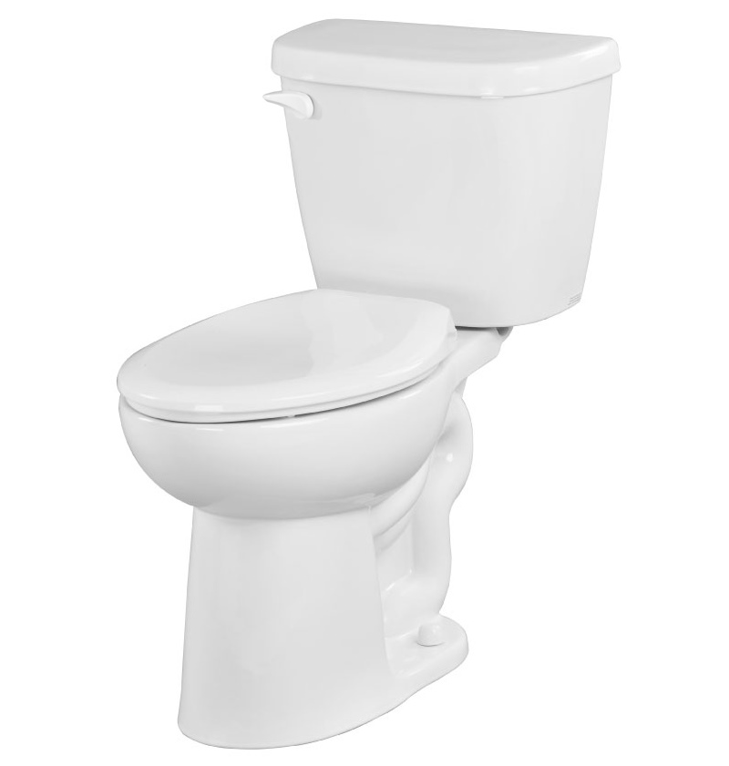

The CST776CEFG and CST776CSFG will be ADA compliant with the seat installed. Even the 1.28 gives you a good flush rating of 1,000 grams on the MaP testing.
Tanks can have either standard left hand trip levers, or optional right hand levers.
The bowl finish on these is very good, and the swirl rinse helps to keep them clean. They are a very good choice I believe. The trapway design is also very good, with it's long sweeps and how it points waste down the drain. I like these much better than the Gerber products.
