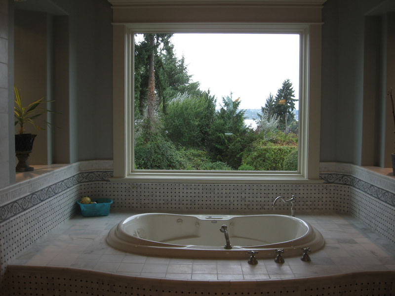

If you could drop a tub into place and the bottom of the tub perfectly touched the floor at four points, you wouldn't need shims or addtional support.
However, what a shame if you tiled up the box, and the tub sets up even 1/4" of an inch. Then what?
What do you do with the gap?
I like to plan for about 1" under the tub.
Then I put a few piles of mortar down, and let the tub squish the piles.
If you try to make a perfect bed for the tub, it will not spead and let the tub conform as needed.
You may wind up with a tub setting up 1/4" or more above the deck.
The piles allow for spreading.
It's the same reason that trowels for tile have notches.
