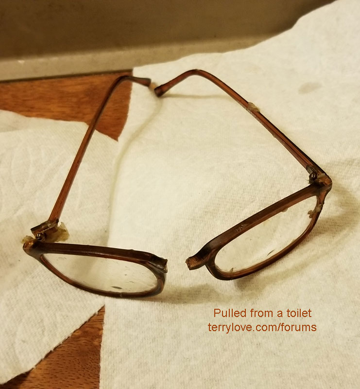

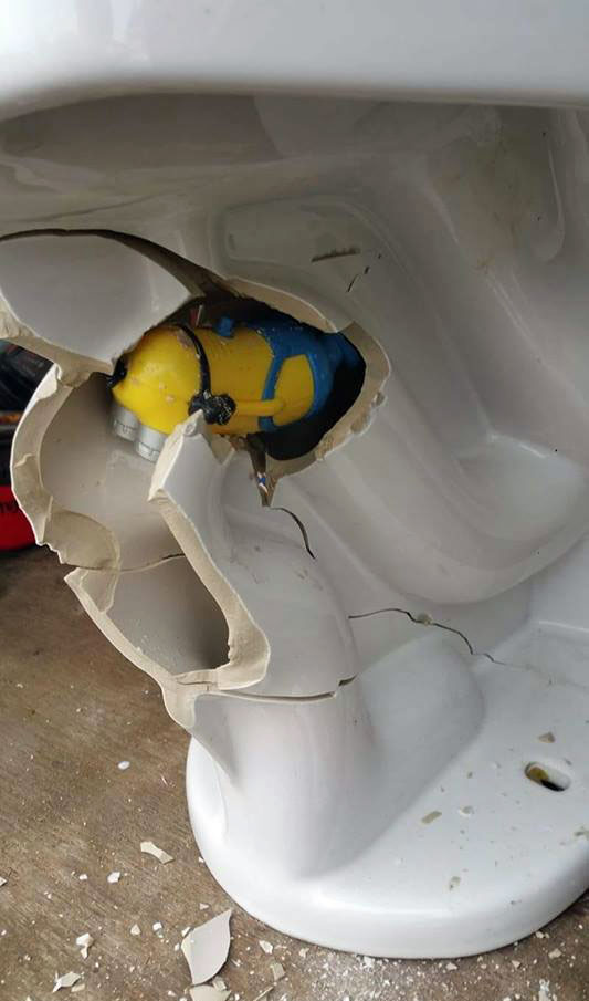

The augers with the small ends can sometimes slide right by the obstruction.
I would guess you issue to be something in the trapway of the bowl. Sometimes it's easier to just replace the bowl than to pour acid in it and hope it dissolves what is there.
