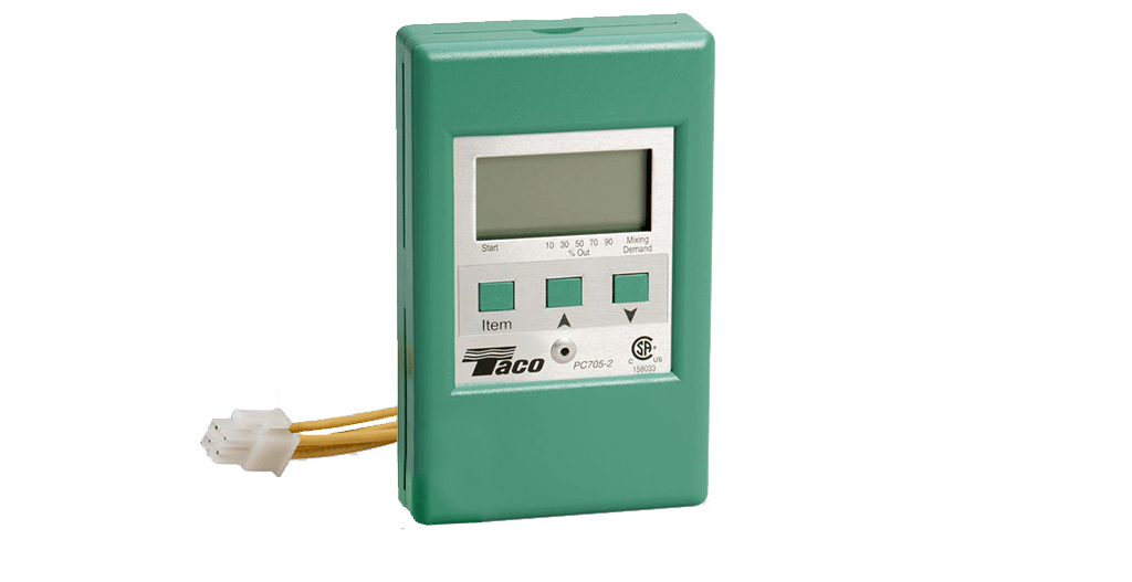

This control might do what u want. Outdoor reset and variable speed. Also with injection don't need a mixing valve.
water heater side of hx why have variable speed any heat not used goes back to the heater. Most boilers supplying both dhw and heat also use a priority control. Shutting down heating for dhw.
