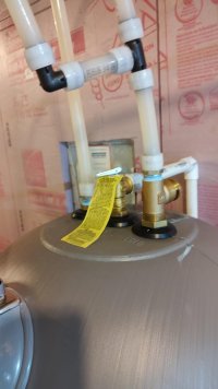

Recently had a new Rheem 50gal Marathon electric hot water heater installed. It was also connected to my geothermal heat pump's desuperheater - a direct connection to the bottom of the tank, not to a "buffer" tank. I have the water temp set to 130deg, but I only get 114deg in the morning hours. I don't have a daily routine so there are days I don't use much hot water in the mornings. My concern is I don't like the water temp going down that low due to the possibility of bacteria growth. I was told by the heater installer not to change the temp setting on the lower tank's panel where the desuperheater line comes in, but to leave it at 120deg. My question is, is there a way to have hotter water in the mornings? Would a recirculation pump solve the problem? Should I increase the temp on the tank's lower/desuperheater inlet? Is there some other type of configuration that would automatically increase water temp to maintain it's set temperature? Is installing a "buffer" tank the only solution, and if so would it maintain hot water if the geo unit is not running consistently in mild weather? What about a mixing valve/tank booster?

Normal electric heater wiring the top element gets power till thermostat satisfy
then sends power down to the bottom thermostat till it satisfy and sends power back to the top. Top thermostat calls powers the element satisfy then to the lower. Like to see a pic of the heater with piping and a wiring diagram usually in the manual or under the element covers ( turn power off before removing them).

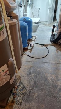

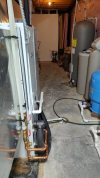

Attached photos showing desuperheater connections and wiring diagram.

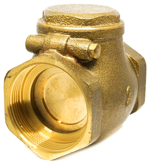

Heater is wired like my post 2. Heater 1 pic the swing check valve looks to have the flow going down. A swing check can't be used in any vertical position especially down. Needs to be a spring check or the swing check has to be in a horizontal line. The existing check has a small 1/4" hex bolt head towards the top of of it which is the pivot point of the swing. Guess the pump for the line is at the geo unit?

The desuperheater is built into the geo. It's my understanding a swing check valve can be used in in a vertical position if in an upward flow. Do you have any solutions to my issues or questions?

No it can stay in the open position in the right condition. Looks like it's feeding in the bottom.

I turned off the geothermal desuperheater and closed the inlet/outlet valves (Rheem recommended I do this). Set the upper and bottom temp settings on the Rheem electric water heater to 125deg. Now I'm getting hot water whenever I want it. I plan on turning the geo desuperheater back on during summer/AC months as I understand that is when it can be most effective/helpful.

Desuperheater should work on any mode. With plastic pipe can't set up proper flow without having a way (drain valves) in and out Dhw lines from the desuperheater to get good temp readings. Having temp reading at start up would give good comparison. The heat exchanger could also be fouled. Page 13 has some startup info.
