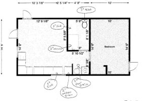

Hello, I was wondering if someone could give me someone help on venting a plumbing stack for a very small living space I am putting in a shed. I've added an overhead plan and sketch drawing. I also have a few physical pictures I can add if its helpful. Basically its 1 toilet (3 inch), 1 sink (2 inch) and 1 shower (2 inch) in a bathroom. Then 1 sink (2 inch), 1 washing machine drain (2 inch) and 1 floor drain (2 inch) outside the bathroom. The main pipe is 3 inch.
Questions I have:
1. Which connections need a vent attached?
2. May I run 2 separate vent pipes 1 from the bathroom and 1 from the sink/washing machine on the other?
3. If I do run two separate vent pipes is 2 inch an acceptable size for each vent?
4. Is the vent required to run out of the roof or can it be ran out of the sidewall?
4. Any other thoughts or recommendations?
Thank you for your help!

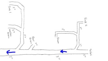

A couple of notes on this drawing. The whole bathroom group is horizontal unless the line on the drawing is vertical. A vertical line means vertical pipe. You can barely see the toilet riser. The vertical line for the floor drain looks like a tee but it should be a wye with a 45. The floor drain vent goes in your partition wall for the cabinets. You can combine any of the vents but it's usually easier in the attic or roof joists.

Thank you very much John. To clarify what I am seeing on this drawing. The vent pipes you show are attached to the bathroom sink, the floor drain and the washer drain (with an additional teed in vent from the kitchen sink). Is that correct? No vent pipe on the shower fitting or toilet? Thanks again.

Yes. As long as the pipe from your shower trap to the 3"is less than 8'long you won't need a vent. The piping would needs to be horizontal (with slope) and the riser from your trap up through the shower floor needs to be less than 2'long.

But you need to vent at least half of the crossectional area of a 3"pipe through the roof. 3.14xR² is the formula. Since your main is 3" the radius is 1.5". 1.5x1.5=2.25x3.14=7.065÷2=3.5325sq. inches worth of vent through the roof. So two-2" pipes or one 2" and one-1.5" pipes need to go through the roof.
