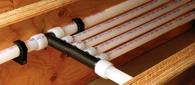

PEX is only good for two plumbing fixtures at the most. For one bathroom, that would be 1/2" PEX for the lav and tub, and 3/4" for the tub, lav and toilet.
If you're doing two bathrooms, then start with 3/4" for both hot and cold.

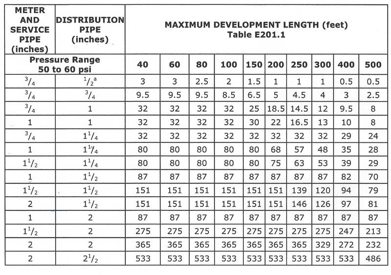

so if I got this right I have 32 fixture units and I assume the hot water heater would not be more then 4 so I am at 36 or less. Distance is less than 40 feet and pressure is controlled by a pressure valve and set at 50 so that should be good.
I have at least a 1" (copper) main line coming into the house but the chart says I need 1" distribution in the house?
I have 3/4 (copper) on the house side of the meter for distribution throughout the house. so they let 3/4 as supply into the house but want 1" distribution?

We work backwards on sizing.
We also have 3/4" water meters, but then run either a 1" poly line from the meter, or a 1-1/4" PEX line if we have three bathrooms.
I have seen house flippers run 1/2" and it's a big regret for the homeowners.

That's a manifold system that starts off from a 1" manifold and then breaks down to 1/2" or even 3/8" for individual items.

Two bathrooms
From the 3/4"
1/2" PEX to the double lav and the tub H&C
1/2" PEX to the toilet C
Half bath
1/2" PEX to lav and toilet H&C

What is the longest run of piping to the most remote fixture? That's you determine the footage. If your using the 40' column then your saying from the meter to the water heater then from there to your last fixture is your longest run of pipe and that's 40'?
well ain't i stoopid. the water meter is outside duh so probably another 35 foot to where the pipe enters the house and it is 1" main line into 3/4 PCV set at 50 PSI but can go higher as city pressure is quite high was at 70 PSI i think which is why i put the PCV on the line.
just measured from where the pipe enters the house and it should be just under 40 foot in distance, height is one story plus height to shower valve so maybe 12 foot at most.
so are we looking at 35+40+12 = 82 feet?

So using 84 feet of pipe and 44 psi map out your piping on paper using the plastic pipe chart. This will be the most stringent. Start at the service, and meter, then skip to most remote fixture work your way back sizing each pipe segment. Change the ones you have access to, leave the ones you don't have access to. The inspector shouldn't ask for much more than that. No one is going to answer a convoluted question about mixing all different kinds of pipe and tell you if it's going to work.
It sounds like you could bump your regulator outside anyway so even if you size it improperly here and there the bump in pressure will even out the mistakes.
