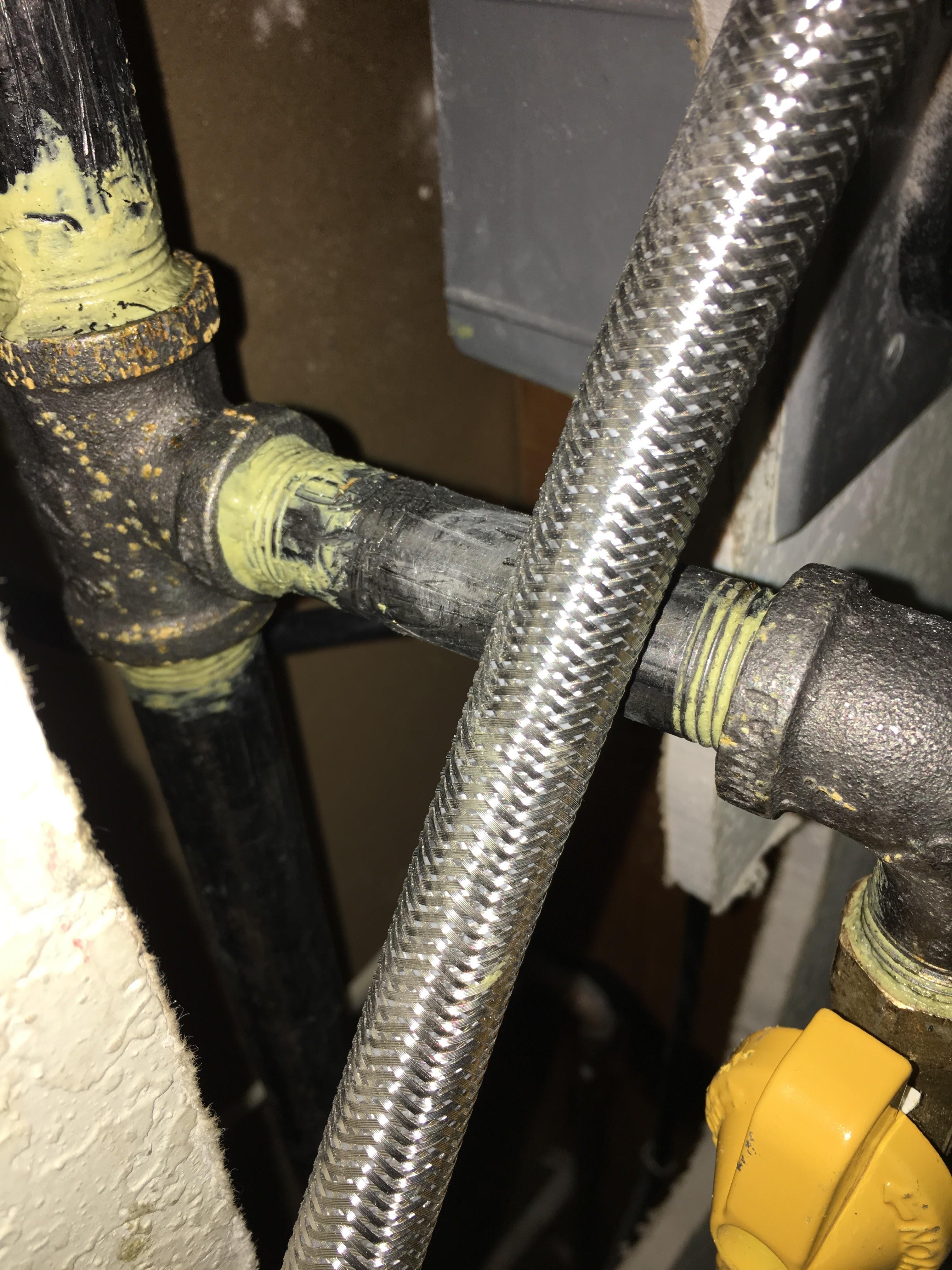

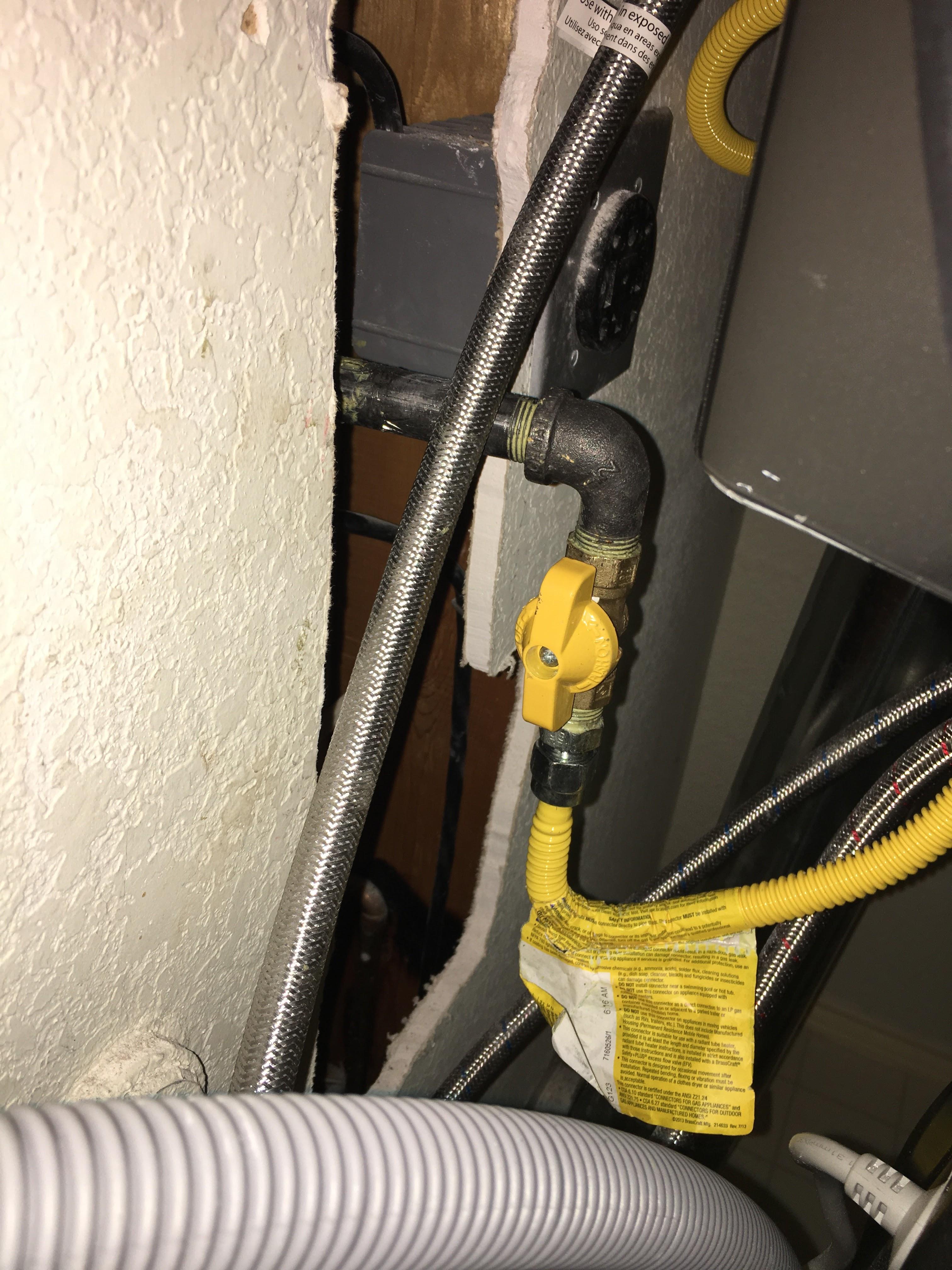

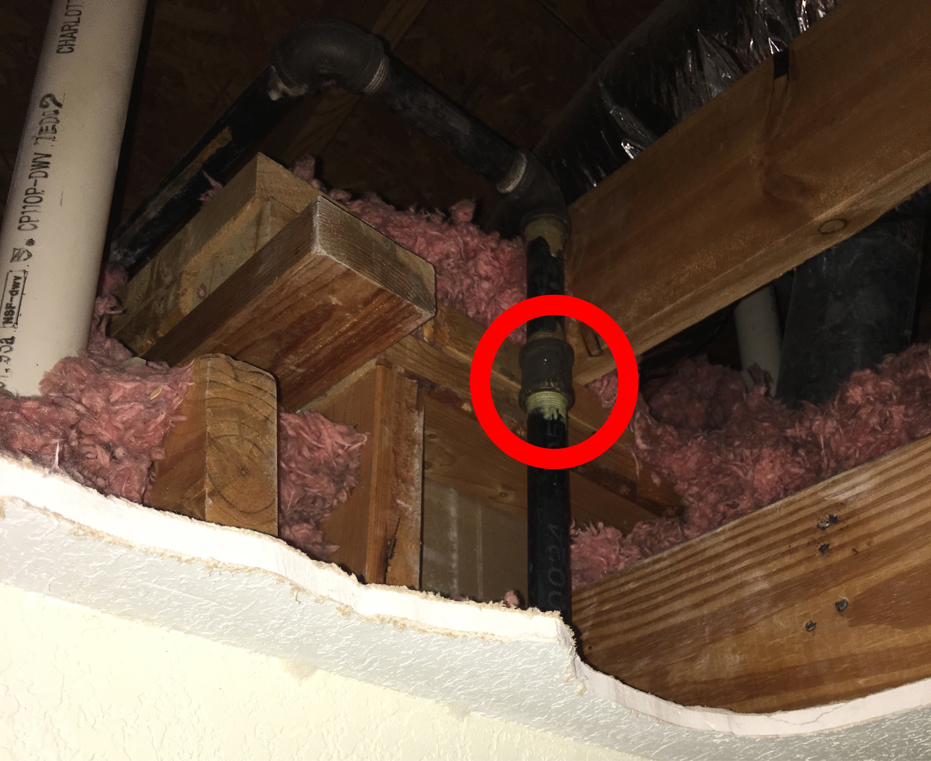

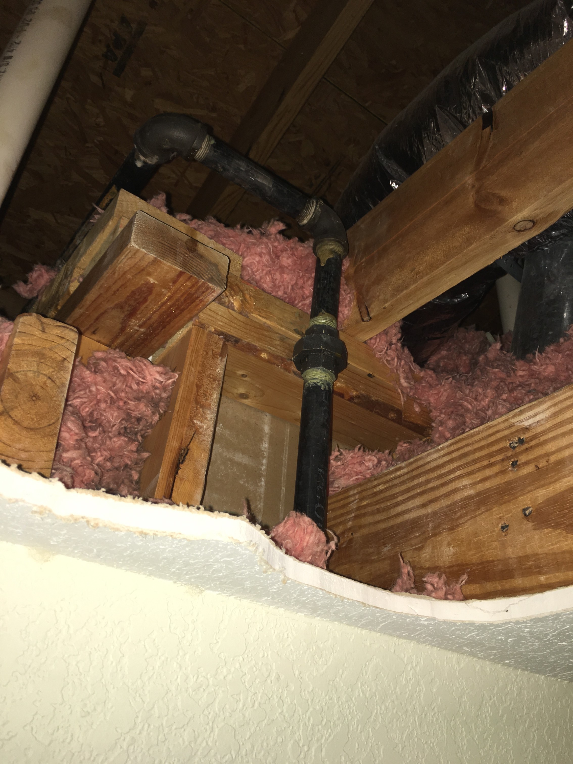

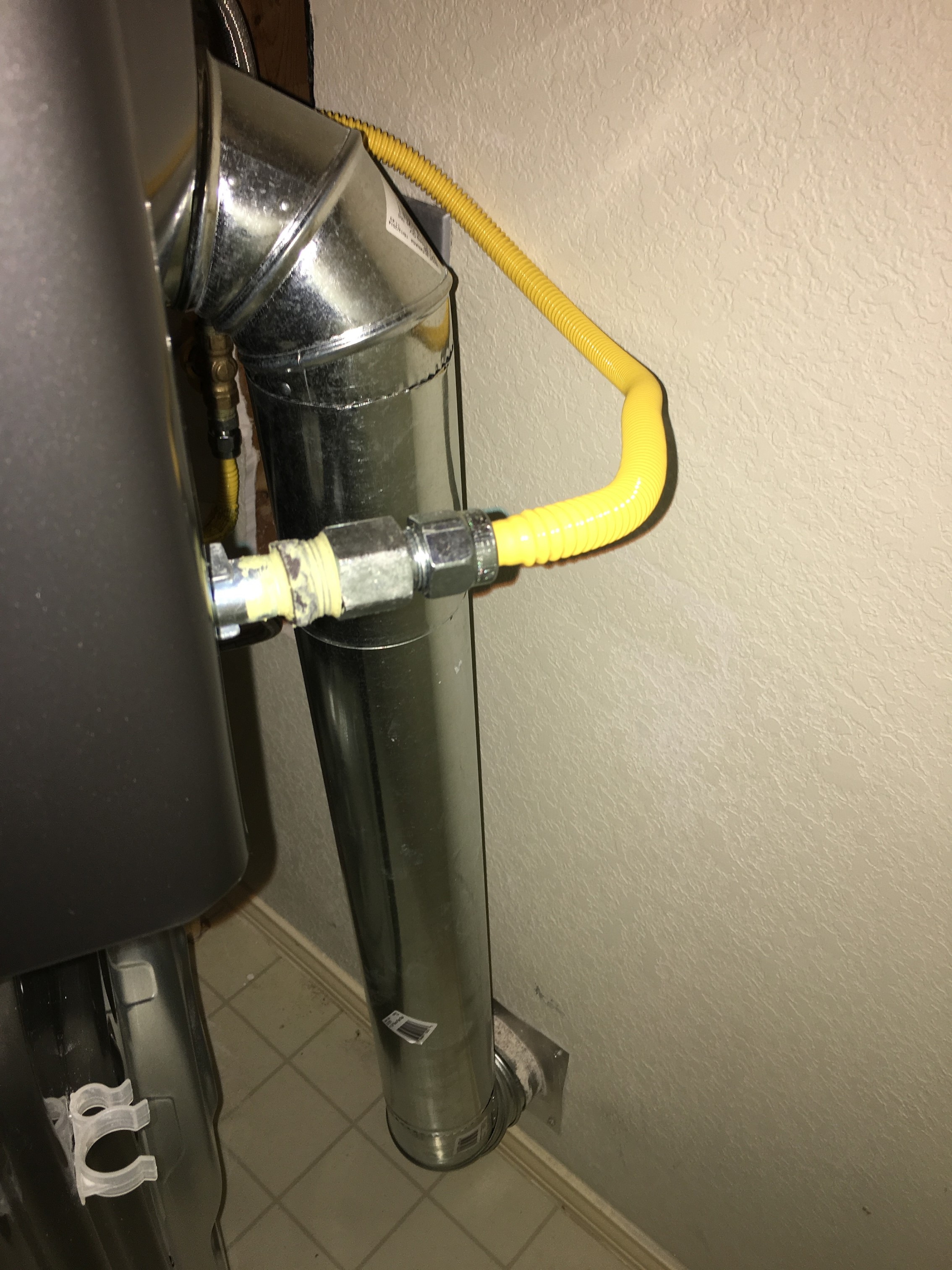

Getting back on topic, big thanks to all the non PSAers who contributed knowledge and experience to help me finish my project!! New dryer is working great on the new gas connection!! I was able to remove a coupling (seen in the red circle) from the attic portion of the leg and replace with a ground joint union while keeping to code. I attached and tightened starting at the bottom of the pipe at the 90 bend in the garage and working my way up to the tee then to the union. This allowed me to fully tighten each piece all the way up to the union nut. Checked with gas leak detection fluid and everything is tight and leak free! I did have to open the outlet to the water heater in the garage to purge the line of air before reconnection to the water heater and re-lighting the pilot. My next gas project will involve extending the line for a gas stove, and I now feel more prepared for that endeavor! I'm about to get really good at patching drywall! ;)
I also got to cut sheet metal for the straight vent for the first time. Lots of great learning moments in this process.

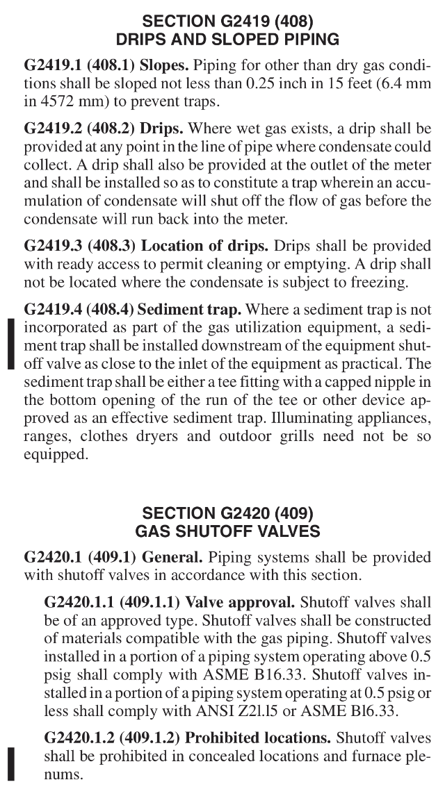

Check you local code. I would suggest a drip leg at the dryer valve (others may not?).
Not a pro BTW...
Per gas code a sediment trap is not required on a gas dryer. California may have an additional requirement for it though ( not here in Texas)

I am hardly a troll. Other than pointing out that a drip leg (not to be confused with a sediment trap) might be a good idea and/or a code requirement, I have made no criticism of your work. To me, it looks like you did OK. Like many others, I personally would have avoided the union by tearing everything out and starting over.
I happen to also live in Texas part time. Pretty much the same code as CA. The code is a minimum, not a gold standard.

You CANNOT just insert a tee by trying to tighten both sides at the same time. You need a union, and more experience.
NYC
Unfortunately Required left right nipples and coupling EXCEPT a union was allowed by the appliance
It is not for everyone as even someone experienced can still cause a leak
