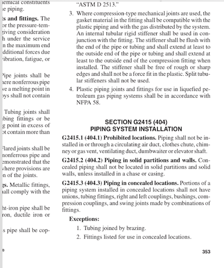

After further research (international gas code) it appears that Unions are not allowed in "concealed locations," however I have access to a nipple in the attic where a Union would be permitted.
Looks like that pipe is in a wall. Not sure what your code says, but where I live, you are not allowed to use a union inside a closed wall. If it were my project, I would do it as dj2 said, disassemble completely and reassemble from the source to the end.
To recommend complete disassembly in this instance and in most is absurd! That's like telling someone trying to build a home addition to takedown all the walls to do it "right." I have a gas starter fireplace, a gas furnace in the attic, and a gas water heater in the garage. I'm not going to demo my house to add a clothes dryer.

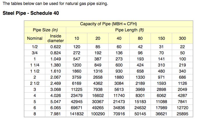

Since you are adding an additional appliance, you may need to recalculate the BTU load on each section of pipe back to the source. Replacement with larger pipe may be necessary.
Drew Toddsby
10
Texas, USA
Very first thing I did before I touched any pipe or cut any holes was research and calculate load for each line. I also verified my meter had the overall capacity I needed to supply the calculated load. Dryer is around 22,000 btu, furnace around 50,000 btu, and water heater 40,000.
dryer leg didn't add any distance, furthest on leg is furnace at 30ft. Gas starter fireplace is on a separate leg and will never be used at the same time as the other 3 applicances
1,193
Make sure you add the 'effective' length of any fittings to the max length values on the chart.
