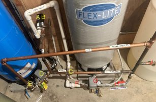

I think pipe B is from well 1. If that is correct, then valve C is between the well one pump and the pressure switch.
Pipe A is from well 2, and there is no valve between A and pressure switch G.
I presume pressure switch D controls well 1 pump, and I expect the breaker for well 1 is off.
A and B are both old lines from the old well (#1). When I turn C off and on, water from the well hydrant immediately shuts off/turns back on.
The new well(#2) was recently installed. The incoming water is the black piping alongside the right side of blue tank and under D which controls Well 2. Its breaker is always on, as its outdoor hydrant is used daily to clear out the shale water outside. I plan on bringing the water into the house soon to alternate with the old well 1.
