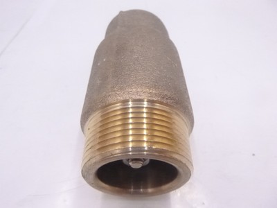

Any suggestions on what to look for in an auxiliary check valve to connect directly to the pump outlet? Any brand/model suggestions? Will it decrease the flow or pressure?

Expect a check valve to drop the pressure about 2 psi. Must be spring-loaded.
