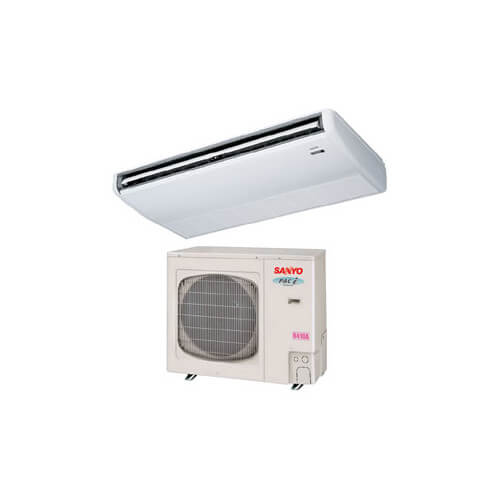

The conduits housing the insulated refrigerant lines DO look a lot like high-velocity mini-ducts, but "ductless" is a key factor in the high efficiency of ductless systems. Without ducts there's no duct leakage losses or backpressure increasing loads to the air handler. If you literally never clean the filters on the interior units of split system it'll cut into efficiency measurably, but not as much as going to a ducted system. Using indoor units with continuously-variable speed blowers rather than some of the simpler 2-speed also improves average efficiency.
The ceiling mount units tend to look like this:
But there are flush-mounted versions too:
Most of the ceiling mounted units are well north of 10,000BTU- finding one appropriately sized for a bedroom might take a few discussions with distributors or manufacturer's reps, since they're usually targeted at larger commercial installations that have far more ceiling than wall as opposed to single-office/room type installations.
