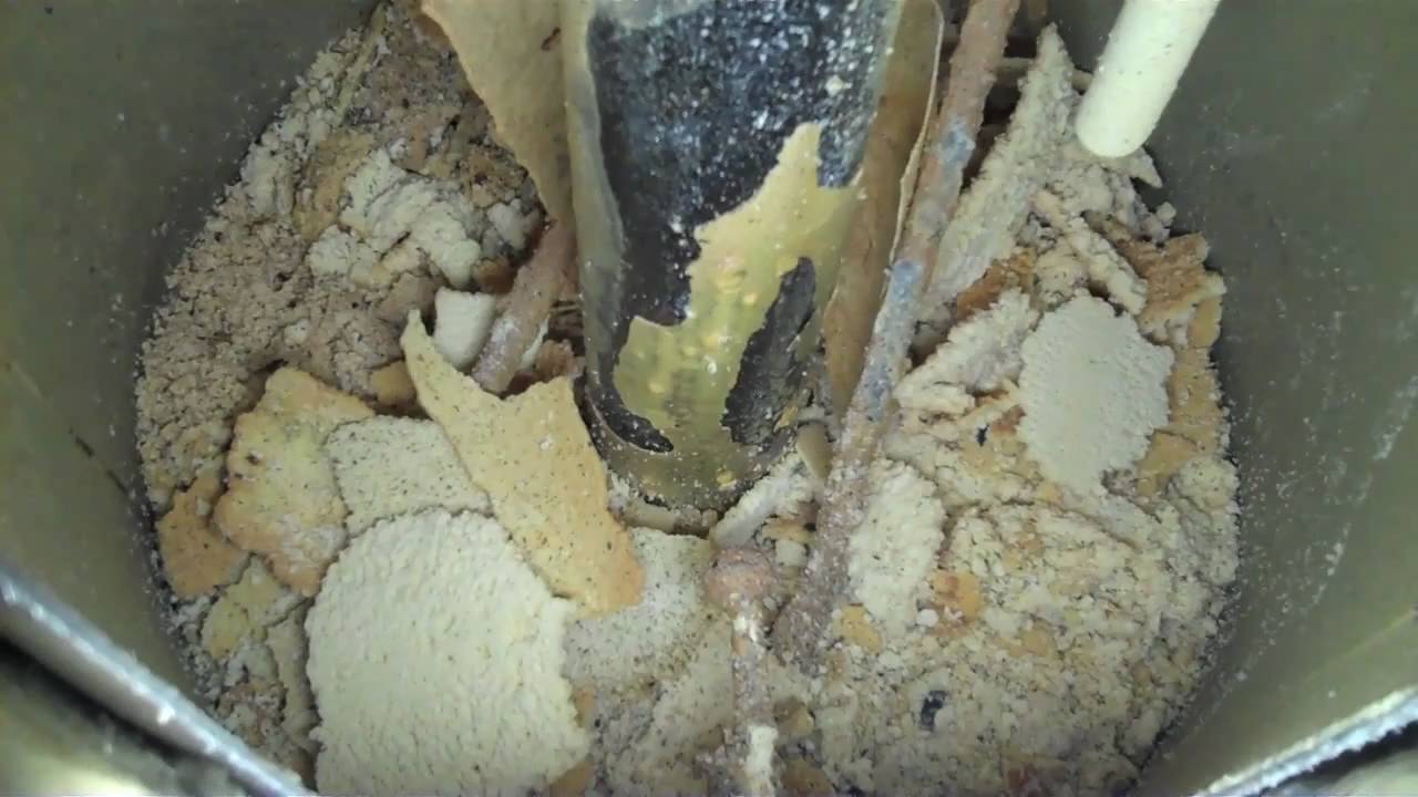

Hi,
We have a property with two manufactured houses. One house came with an old tank-style water heater already installed. The other house didn’t have a water heater, so about nine months ago, we installed a new tankless water heater along with new PEX piping.
The house with the old tank water heater hasn’t had any issues so far. However, the house with the new tankless water heater has been producing a significant amount of white buildup, which keeps clogging the faucets. I cleaned the buildup with chemicals just a month ago, but I’ve already noticed a considerable amount forming again. I researched the issue and found that tankless water heaters—especially models that can’t be set below 120°F—tend to cause more mineral buildup than traditional tank water heaters.
When I installed the tankless water heater, I also added a Scale-RX filter. Based on my experience, it hasn’t been effective, or the water might be too hard for it to work properly.
I reviewed the water report, which showed iron levels between 300 ppm and 1500 ppm—an extremely high range. However, I believe this might be a typo. It’s likely 1500 parts per billion (ppb) instead of parts per million (ppm), making the actual iron level between 3 ppm and 15 ppm. While still high, it’s not as excessive as initially reported.

3 ppm iron is a lot for a softener to handle. It would need some extra treatment for the softener periodically. It may be that layering in Iron Out powder with the resin would do it, some periodic treatments.
Your photo seems odd/suspicious. Did you take a photo, or is that some photo you got elsewhere? If you had hardness materials together with iron, I would not expect precipitate to be segregated into white and brown chips. Maybe the white chips are your precipitate, and the brown is unrelated to the purpose of the photo.
The one tankless manual I happened to be looking at recently said not for use with hardness over I think about 11 grains. Earlier I saw one that called for no more than 7.
Measuring hardness is easy and accurate with the Hach 5-B hardness test. Iron is not so easy to measure at home.

Thank you for the detailed answer. I took a picture. When I removed the PEX pipe, many of those white particles came out. To clarify, the dark brown color is old plywood, not a mineral deposit.
I attached another picture I took after removing the shower faucet.
I believe I could easily accumulate the same amount within a month.
Today, I tested the water using my pool water test kit, which provided an accurate hardness reading:
Calcium Hardness: 480 to 500 ppm (around 29 grains)
TDS: 567 ppm (I measured TDS and pH with a device I got from Temu, but I’m not sure how accurate it is. I have a better one that I’ll use next time.)
pH: 7.9 to 8.3
Please let me know what would you do if you were me.

That doesn't look like hardness deposits to me. Maybe I am wrong.
Hardness deposits will dissolve in an acid such as 5% vinegar. Hardness deposits will not burn, where organic debris will burn in a flame.

Heating water will cause hardness minerals to precipitate out from the water, and collect on the hottest surfaces.
A tankless water heater is designed to supply a large amount of heat to moving water within narrow water passages within the unit's heat exchanger, to cause the temperature of the water to almost instantaneously increase by often 70 or more degrees before exiting.
Many tankless units have a gas input up to 199,000 btus, so the hardness minerals in the water within the narrow passages will rapidly accumulate on the passage walls, where they will reduce heat transfer, and may block each passage completely.
Although a tank type gas WH will typically have a gas input rating of 36,000 BTUs, because the burner is usually located directly below the water storage tank, minerals will accumulate mainly on the bottom of the tank and also on the surface of the vent pipe located through the center of the tank. This accumulation will increase fuel consumption due to the minerals acting as an insulator, thereby forcing the burner to operate significantly longer to heat the water to the desired temperature. See images of the inside of gas heaters below.
