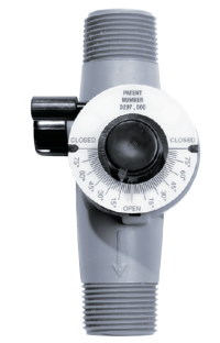

BTW I'm putting in a Cycle Stop Valve too instead of replacing the failed 34gal tank. The kit came with a check valve. Should I omit the check valve?
Another question: I'm wondering what to do with the WellMate Micronizer air injector that was installed just before the gunked up check valve, which was there as part of the iron treatment system. I'm replacing all that too but haven't designed it yet. If I eventually put the air injector back in, where should it go? Before or after the the CSV? Any other tips about this?

Thanks for adding the Cycle Stop Valve. You will be glad you did. But that is not one of our kits as it has a lot of unnecessary parts, including the check valve. It will work fine, just don't use the check valve.
A Micronizer adds another level of complexity. To get the Micronizer to work with a CSV a fairly large pressure tank is needed. I don't think a 34 gallon tank is large enough for a micronizer even without a CSV. I would use at least a 44 gallon size tank that holds 10 gallons of water. With a 40/60 switch setting the CSV at 58 PSI will allow full pump flow through the Micronizer and it will draw air until the tank is full to 58 PSI. At that pint the CSV goes to work and either matches pump output to the demand or restricts it to 1 GPM to finish filling the tank from 58 to 60 PSI.
There is usually not enough flow being used to make a Micronizer work when the CSV is matching demand. So the little larger tank lets the Micronizer work before the CSV does anything.

Ok thanks. Is the check valve simply unnecessary, or does it actually interfere with the CSV performance?
41,408
4,996
It is a detriment to the system. For one thing, it can cause you to not keep your piping under pressure, so a small leak thru the yard theoretically could suck in contamination. For another, it could provide a shock as the water slams the poppet.
It does not always cause such symptoms. There are places where the above ground check valve is required, and others where such a valve is forbidden.

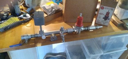

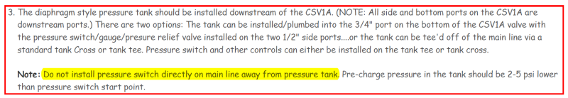

Below is a photo of the kit I have. Is it OK to install the pressure switch where shown, downstream from the CSV? The CSV install instructions specifically says not to do this, i think. But isn't the pressure going to be identical anywhere downstream from the CSV? If so, why would it matter if the switch and gauge are downstream a little? If they need to be installed on the CSV side ports I think I need to go get some extra fittings.

The pressure switch and pressure tank must both be downstream of the CSV, and the pressure switch and pressure tank should be close to each other. The wording you marked in yellow could be better.
When water is flowing, there is always a pressure differential. You want the pressure differential between the pressure tank and pressure switch to be small. The pressure switch location in the photo you posted would be close enough, since the critical time is when the pressure switch approaches cutoff. At that time, the flow has been reduced.
It should work fine, less the check valve. But the closer the pressure switch to the pressure tank the better. As long as it doesn't bounce the pump on/off on startup the switch location will be fine.
