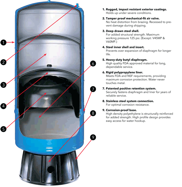

Normally an 86 gallon tank would hold about 21 gallons of water. You could measure that when the tank is at max by turning off the power to the pump. Then see how many times you can fill a 5-gallon bucket.
Looking at the condensation mark will not be a good indication, because the diaphragm will have a dome shape. This picture is from a Well-X-Trol, and not all tanks will have all of these features. This does illustrate the diaphragm shape when full or almost full. Mostly compressed air in the tank.

Technically, an 86 gallon pressure tank holds 23 gallons at 40/60 pressure. But that is if everything is set perfectly. You can't get a large enough pressure tank to eliminate pump cycling. Adding a Cycle Stop Valve will stop the cycling no matter the size of pressure tank. But you really only needed a 5 gallon size tank with a CSV.
