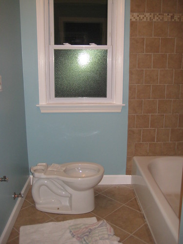

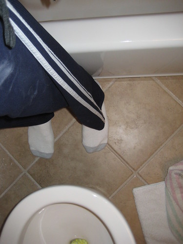

I have a skinny bathroom in a 1939 home. The bathroom is only 43" wide between the wall and tub. So I did the stupid thing and just bought a 14" rough AS Cadet 3. Threw it in tonight and it is not going to work. The front of the bowl is too close to the tub (as you can see).
What are some shorter options for a 14" rough? This is 30.5" from wall to front of bowl. Neither round/elogated or height is an issue.

Toto Carlyle and vespin with a 14" unifit adapter would each be about 28" from the wall. Both are elongated. If nothing else, they would be closer to the wall. I think that just looks terrible so far away.

So Toto Vespin and Carlysle both have elongated bowls and with the unifit would get me another two inches, which would be nice. Maybe it doesn't come off in the pictures, but it seems very close.

You can't meet code like that. You need 24" in front of the bowl.
What about turning that toilet sideways? Will there be a sink or vanity in the way?

There's no way i can get 24" in front of toilet. Even with the options listed above, 43" between wall and tub - 28" (Toilet) = 15" of space. I'm not sure what I could have done, just ripped out the toilet that had been there since 1939 and it has not had more than 18" since then.
Can't turn it sideways as the vanity is between the toilet and the door and I had to buy a tiny vanity to even make this set-up work. The good news is that side to side, I have plenty of room to meet code.... just the dang front is screwing me up.
My city doesn't require inspections when you sell your house, so I'll likely get away with it. I hope. Not sure what I could do other than rip out the wall and enlarge the bathroom? They don't make any skinnier tubs, I had enough trouble getting one to fit in there.

3,481
Sometimes a bathroom has a non-standard dimension for the toilet rough-in. Standard is 12"
Sometimes you will see a toilet roughed in at 14".
You can always use a standard 12" rough toilet for this, but the bowl sets out from the wall an extra 2"
You can order thicker tanks from some manufacturers, that hide the fact that the bowl is setting 2" farther out, but the end of the bowl will still be out in the room.
There is one manufacturer that "moves" the bowl back 2".
You pay more though for this advantage.
Models from Toto that allow you to move the bowl back 2" with their Unifit adapter are:
Vespin
Carlyle
Carrollton
Carolina
Lloyd
Pacifica
Soiree
Guinevere
With the Vespin and Carlyle, the shutoff can be 7" to the left of center.
With the Soiree and the Guinevere, the shutoff can be 5-1/2" to the left of center.
Most of these are 28" long and set off from the wall 3/4"
So on a standard 12" rough, the end of the bowl would be 28-3/4"
If you have a 14" rough, you can switch for a 14" Unifit and keep the distance to 28-3/4"
The 14" Unifit needs to be ordered in addition to the toilet.
They come with the standard 12" Unifit, which winds up being an extra part.
And no. I don't need anymore 12" Unifit adapters.
So to explain how this works:
Cadet 3 14" rough "round bowl" is 30-1/4" from the wall.
Cadet 3 14" rough "elongated bowl" is 32-1/4" from the wall.
Any of the Toto toilets above will be about 28-3/4" from the wall with the elongated bowl. Shorter then most other round bowls, and much shorter then the other elongated bowls.
You pay more, but get a better toilet, and more usable space in the bathroom.
Your call.
