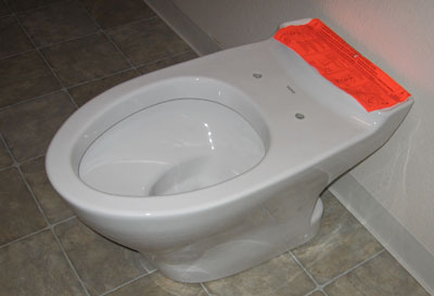

Here's the story: We're in the midst of a 5x7 bathroom renovation. The major plumbing fixtures are the Aquia II toilet, a Duravit wall mounted vanity with a countertop basin sink and a Runtal hydronic towel warmer, which replaces a small radiator.
I told my plumber what fixtures I had and gave him specs I had downloaded on the toilet and towel warmer. He has pulled the radiator and plumbed for the towel warmer. No problems there. Yesterday, when I mentioned that he would have to drill into the floor to install the toilet, he had a melt-down. He said he didn't sign up to install something complicated like that, at least not for the price we had negotiated for the work. He said he didn't want to have to be sitting on the floor for 3 hours with the instructions trying to figure the thing out — that was money out of his pocket. Apparently, he did not read the info I had given him on the toilet.
Okay. He called me this morning, and had calmed down. He'd even called Toto and gotten installation instructions. After yesterday, I was surprised he had done that. He's got two worries, and after hearing him out, I'm worried too.
The floor is (soon to be) tiled with 1/2" thick travertine, which is installed over durock with a floor leveler over the durock. This is a 110-year-old rowhouse, so there are surprises behind every wall, and beneath every floor. Needless to say, nothing is ever plumb or level. Hence the floor leveler.
My plumber is concerned that drilling through all that material is a) going to be difficult and b) might cause the tile to crack or the floor leveler to be compromised, either of which might cause the toilet to shift and leak.
Also, he said to do the install, he would need at least 8" of space measuring from the middle of the toilet flange to the supply line. There isn't 8"; it's more like 5 or 6 inches. Is he right?

The water supply can even be almost rigth behind the bowl.
See how much room is behind the bowl?
attachment.php
It normally takes an extra 1/2 hour to install these.
Drilling the tile floor isn't a big deal. We use a small rotohammer bit and go lightly.
The seat is installed with black rubber toggles and stainless thread bolts.
These drop in from the top of the bowl, and tighten with a screwdriver.
Do not let the plumber use the plastic nuts and washers that come wth the seat.
The black rubber washer between tank and bowl has no up or down.
Just set it there, and tighten back and forth until the tank is snug.
The water supply is atached to the tank before the tank is installed.
The hose is routed through the bowl and the last part that gets tighened is at the shutoff.

With the bowl not yet in place, I don't know how much room there will be behind it, Terry. I'll tell Mike (plumber) what you say about the water supply.

There right kind of drill and drill bit will make this a fairly easy job. A bit more than a conventional 2 bolt flange, but not that big of a deal. I think your plumber is a bit afraid to try something new and is trying to make excuses for getting you to use another toilet. Don't let him get away with it.
1,193
If the tile is installed properly, and you use the right drill and bit, you should not hurt the tile. Travertine is fairly sort in the scheme of things...a premium porcelain is almost as hard as diamond. A tile bit or a diamond core bit or a carbide bit should all drill into travertine. Depending on how sharp they are, you shouldn't need more than a couple of minutes a hole. The wrong bit, and it could take forever. Depending on how thick the underlayment is, if it is fairly thin, you'd drill through the hard stuff, then use a screw into the subfloor. If it is thicker, you'd use the supplied plastic anchors (requires a bigger hole than clearance for just the screw), then insert the anchor then screw.

Sheesh, I'm a do-it-yourselfer and I installed the Aquia II all by myself in less than 3 hours with no help and a basic set of tools. If I was a pro, I'd consider it an interesting challenge. No offense to the professionals here but in all the improvements I've made to my house over the past 10 years, I've been continually amazed at what babies these big burly tradesmen can be about things -- they don't want to get under the house, they don't want to go into the attic, they don't want to do install something they're not familiar with, they're afraid of my little white dog, etc. I'd hire a new plumber and teach him a lesson.

Its funny, when I had to install my Soiree, I said I would give myself plenty of time to do it (water needed to be turned off so I could replace the valve too, with 2 kids and a wife you dont want the water turned off longer than necessary!)
After all was said and done, installing the Unifit flange took a whopping 15 minutes. Key is having the right tools....hammer drill (even a cordless, doesnt need to be a massive Hilti) and a good masonry bit (Blue Granite by Bosch is my favorite). Granted I didnt have ultra-hard porcelain, or soft travertine....somewhere in between. I think the bit is the most important part of the whole deal.
Also helpful was having a center punch....I installed the unifit to the existing toilet flange without any wax ring. Tightened the nuts down just enough to hold it, made sure it was square to the wall, level, etc. Once in place I center punched the 4 holes where the rear screws needed to go. Removed the unifit, drilled the holes, installed the plastic anchor inserts and reinstalled Unifit with the wax ring. Everything lined up perfectly.

We charge $179 for most of them, and $199 for the Aquia.
That's if we supply the toilets.
It's more if the customer supplies them.
And the Aquia, should be about $50 more than a standard install.
