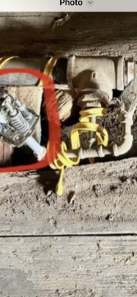

If your P tank is not equipped with a Tank Tee, how is the tank connected to the supply lines and, how is the P Switch, P gauge, and any other valves (such as Pressure Relief Valve, drain valve etc) connected? Post photos (low resolution).

Pressure tank is connected with 1-1/2 poly with p switch and gage attached to that with T and threaded reducer.

Pressure comes from the pump, not the tank. If the pump can only build 52 PSI, that is the problem. Like Fitter said you will loose 11 PSI to the elevation and even more to friction loss. I would use at least a 50/70 pressure switch, and you will need a pump that can do that. A Goulds J5SH or a J15S can make over 80 PSI and will work with a 50/70 switch.
Oh, and BTW. Adding a Cycle Stop Valve will make the pressure even stronger as it will hold a strong constant 65 PSI instead of letting the pump cycle on and off between 50 and 70 over and over.
