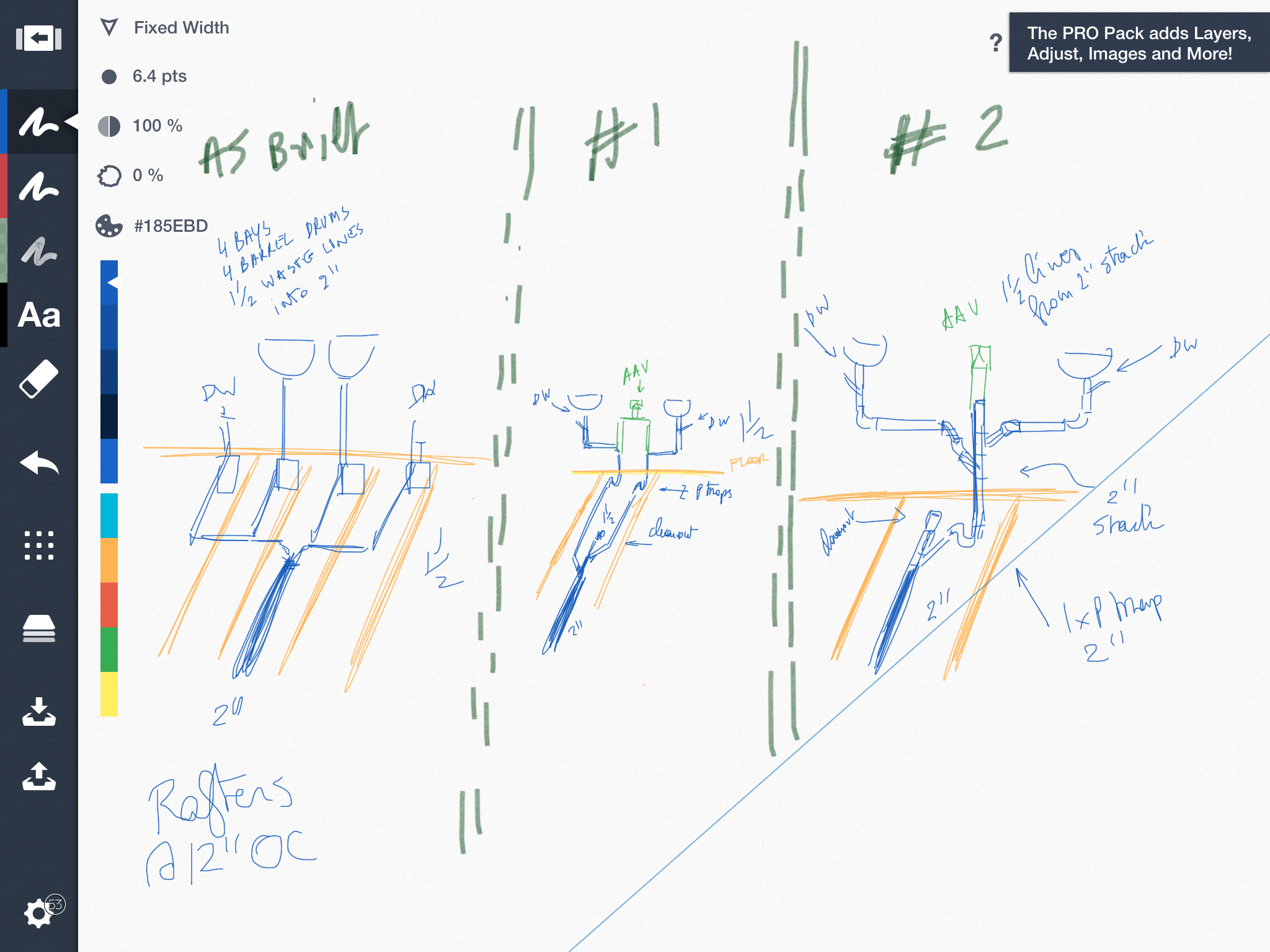

I am seeking some input for a kitchen island remodel, where due to countertop changes new cabinets and plumbing became necessary. Nothing lines up new - old. Trying to simplify and minimize / avoid drilling more holes in the rafters below.
Old setup from the seventies.
Two sinks, two dishwashers. Each with 1 1/2 drain via a drum, going as two arms into a single 2" inch waste line which about ten feet furter drops down five feet into large cast iron. The drum barrel for one of the dishwashers were not in use anymore and they emptied into a disposal. The other one lacks the always recommended high dran loop.
I was hoping to simplify this and have each dishwasher emptying into their adjacent sink.
As the center of the island is open and servicable (made access panels) and not tiled, just an extra layer of plywood, I was hoping to use that void as a service corridor for all water, drain and electrical. (Versus drillng through cabinet bottoms and worse tile flooring)
So I could see 1 1/2 below the sink, p trap into center of island, then run 2x two inch down 10 feet over to the cast iron, with cleanout offset at the end off the 10 ft line etc.
But space is limited as rafters are 12 on center. The old setup seemed ok with a single 2" line. And no p traps in any cabinet, only drums under floor. ( no lnger code as i read it)
So my most simplified idea became, mixing old and new:
1x 2" 10 ft line to center of the island, 2" p trap under the floor, 2" coming up in the void with two wyes of 1 1/2 that go to each sink plus dishwasher and high on top of that 2" pipe, unone of those new air admittance valves.

Envision a 3x3 cube square = nine squares roughly 24x24 each, but with a hollow center.
The dishwashers are on two corners, adjacent to a sink that is in a middle square.
I don't have pictures of the old setup, but I did sketch this out. Slightly simplified perspective wise, as the one sink is offset a bit deeper, behind the dishwasher. The four units of two sinks and dishwasher are basically an L: sink, dishwasher, sink, dishwasher.

The drawings help. I'm not a plumber - and I'm sure someone with the knowledge will be by soon.
But I think you need to have the vent "after" the trap. Where is the vent located for the original (as built) setup?
38,892
4,434
I have limited knowledge, but I know the P traps cannot be below the floor. They need to be before the vent(s) in the path.

The trap arm should not be more than 24 inches below the sink outlet. Drum traps are not allowed.
1002.1 Fixture traps.
Each plumbing fixture shall be separately trapped by a liquid-seal trap, except as otherwise permitted by this code. The vertical distance from the fixture outlet to the trap weir shall not exceed 24 inches (610 mm), and the horizontal distance shall not exceed 30 inches (610 mm) measured from the centerline of the fixture outlet to the centerline of the inlet of the trap.

The original setup, as built had no immediate vent ( only vented via the main house stack ... The 10 ft island drain pipe drops down five feet in the basement into the cast iron mian line ) and was the correct way to vent an island back in the day. I have found a couple older code references that for islands the stand pipe way of doing things (as built) with a p trap below the floor was 100% A OK and the way to go without adjacent vent.
Thank you smooky,
I know drum traps as built are now prohibited. Did not intend to yse them. I found them suspect to clogging the first time I saw them.
Is there still some exception for islands? As old code had it ...
Based on your info / the code, can I do a 1 1/2 sink p-trap under each sink with the special under sink t-piece for a dishwasher ... That connects to sch40 1 1/2 and out 2".
Or am I forced to squeeze four p-traps in??? RE: each plumbing fixture shall be i...
... Because code compliant examples of a dual sink, plus disposal and dishwasher examples 1 under sink trap ...

Thanks for all the input.
Interpreting the above, I need a P-trap in each sink cabinet (which I thought originally) and a clean-out in the vertical part. No double P trap situation so I omit the accessible one under the floor in open basement.
So I should be able to proceed with the following, more conventional setup ... I hope? Yes? No?
PS: I don't like the idea of the sanitary T where it seems stuff can flow left-right-left with those small curved branches, hence I would use 2 WYE above one another where stuff comes in at 45 degree angle and cannot move across. Otherwise I'm going to be back to doing two vertical drain pipes ... and more trickiness under the floor.

You need sanitary tees to allow air to go from the vent to the trap arm. Alternatively, you could put an AAV on each trap arm before each wye.
Icerabbit
Maine
I can see how that makes sense regarding air movement. I was concerned about ideal water flow and angles.
Is there a particular model?
As on the co.lincoln.wa.us site there is a pdf top ten DWV mistakes ... which I'd read a while back and got me concerned about that fitting. Are they simply talking about directional mistake?
Re: top ten plumbing mistakes: installing a sanitary t instead of a wye or long sweep for drainage connection or back to back fittings (sinks) not directional
It would be horinzontal to vertical, proper direction ...
I have seen the AAV per arm example, but they're a bit expensive and one can handle both sinks.
A double fixture fitting.
1.5" on three sides and 2" going down.
Add a 2" cleanout below the fitting. Those trap arms are very short anyway and not likely to be the issue. (Unless you have an old disposer that doesn't chip the food you put down.)

Locating the cleanout ...
Does it have to be below? Or can it be above?
I have some space and height concerns (cabinet base, deep sink, disposal exit height, p-trap ) but think I can make either work.
I guess I though above as that's a guaranteed dry spot and figured that would push down through the joining fitting.
