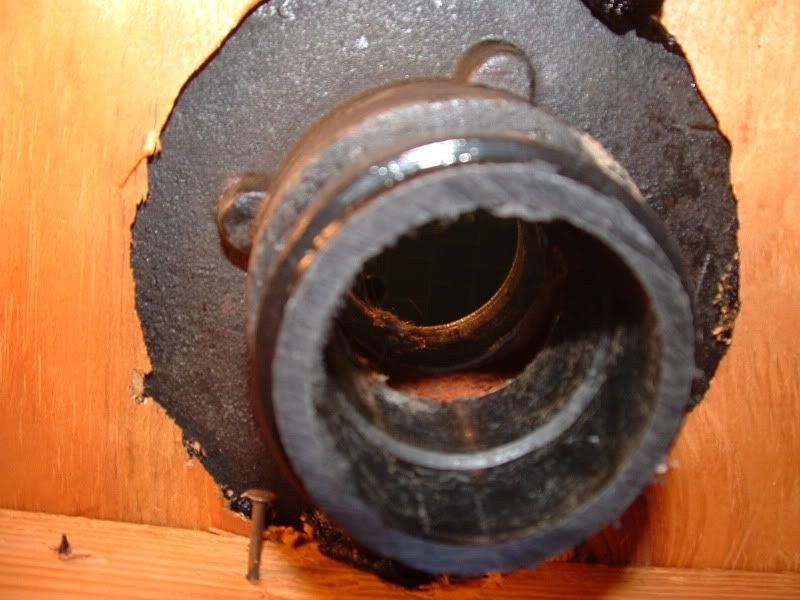

Is ABS plumbing biodegradable? What caused this shower trap to break? I can certainly cut it off on the pipe end to replace the trap, but how can I salvage the shower drain flange in this situation without having to bust up the tile to replace it?
Should I be concerned about other possible unseen cracks in the rest of the ABS waste pipe system? This home was built in 1974.

Can I just glue in a coupler to connect the two pieces back together or would that not be an adequate repair? Definitely want to fix this right the first time before the drywall is replaced.

That is a cast iron shower drain,you can cut it out and remove the male adapter from the drain and re build it.Use the same materials as what was cut out.New materials.
Cut out pipe not the drain that is in the tile floor.

Ok....I think I understand what you''re saying and was thinking the entire assembly was molded ABS and not cast iron. I have a Dremel tool so that should help to carefully cut out the old pipe from the drain. Thanks for the help...! :cool:

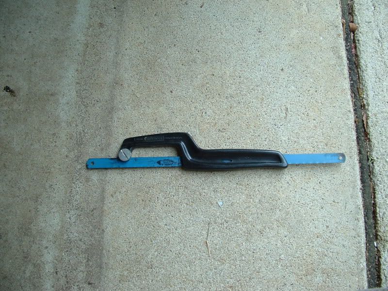

A hacksaw blade would be better for removing the piece of ABS, if it does not unscrew, (which it should), without damaging the cast iron thread, which would cause a MAJOR problem for you. Even a hot screwdriver would be preferable to a Dremel tool.

All of the joints look glued in to me and I can't see any threads showing anywhere. There is no inside drain pipe showing either and it looks like the P-trap is just glued on externally to the shower drain housing with a coupler connection.
Unless I can remove the old pipe and still have something left to attach new pipe on to, then I may end up using an adapter glued to the outer part of the shower drain housing. I saw something like that at the home store this morning that might work.
I'm not convinced the drain housing is cast iron because the ABS is glued to it which should be a threaded connection if it were cast iron.

You have a cast iron drain that is threaded. It does look glued, however the glue doesn't not bond to metal.
Our glue cans have glue on the threads, and while it may be tough, we can open them.
However, if it is too hard to unthread, then like hj mentions, a hack saw blade will work. Plumbers do it all the time. I removed a lot more with hack saw blades then with any other method.
The Rambit is kind of handy, but the if you can pry the plastic pipe out of the fitting, that's a little cleaner and uses less force.

Thanks for the help guys. I'm usually good with plumbing, but this one is a pain. Today I cut the old P-trap out and the drain base is definitely cast iron.
I'll see if I can break the coupler loose, but otherwise will use my handy hacksaw that has saved me many times. Don't worry... I won't quit my day job 'cause I know I'd never make a living as a plumber. :D

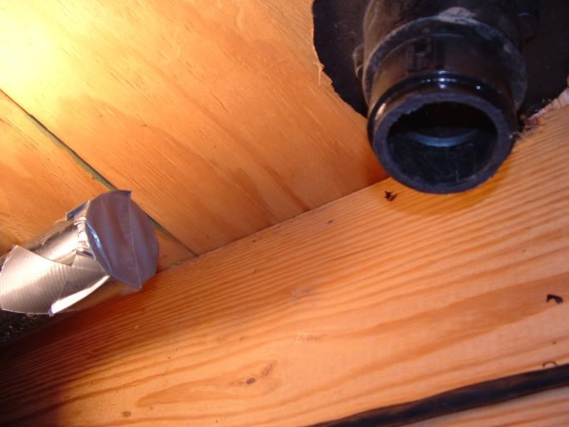

Back to the orginal issue..why did it break? There appears to be an offset, so either the building moved, or the pipe was installed under tension, which is never a good thing.

That's a good question. There is no tension on the pipe that I can see and there are no pipe straps, but I've never seen a P-trap split completely in half like that so the mystery remains unsolved at this point.

If you look closely it appears that those two ell's are actually a couple street's that someone stuck together and then ran a dauber of glue around. U-bends are alway a one piece injection moulded part, there's no way there was a factory seam there. He probably could have just slipped a mission clamp around the two pieces and been done with it. At this point a 2" Fernco will slide over the drain hub.
