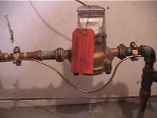

Here is a water meter which might not be electrically conductive (fittings?) and they installed a bonding jumper to be sure of a contiguous electrical connection...

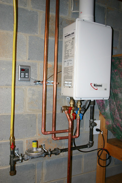

Here they are installing a bonding jumper between the hot and cold water pipes above a traditional water heater tank...

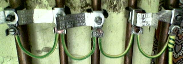

Here there are several different pipes and they have electrically bonded them all together...
