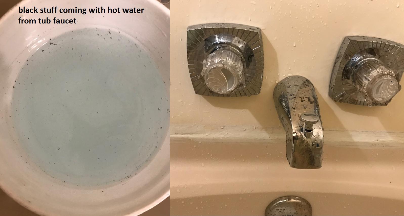

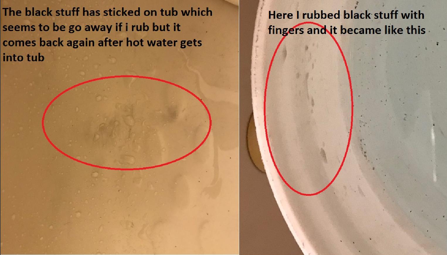

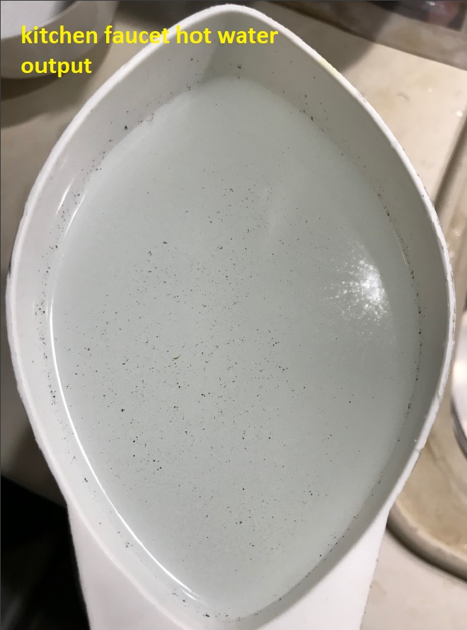

I have this black particles flecks specs residue coming from hot water only all around the house.

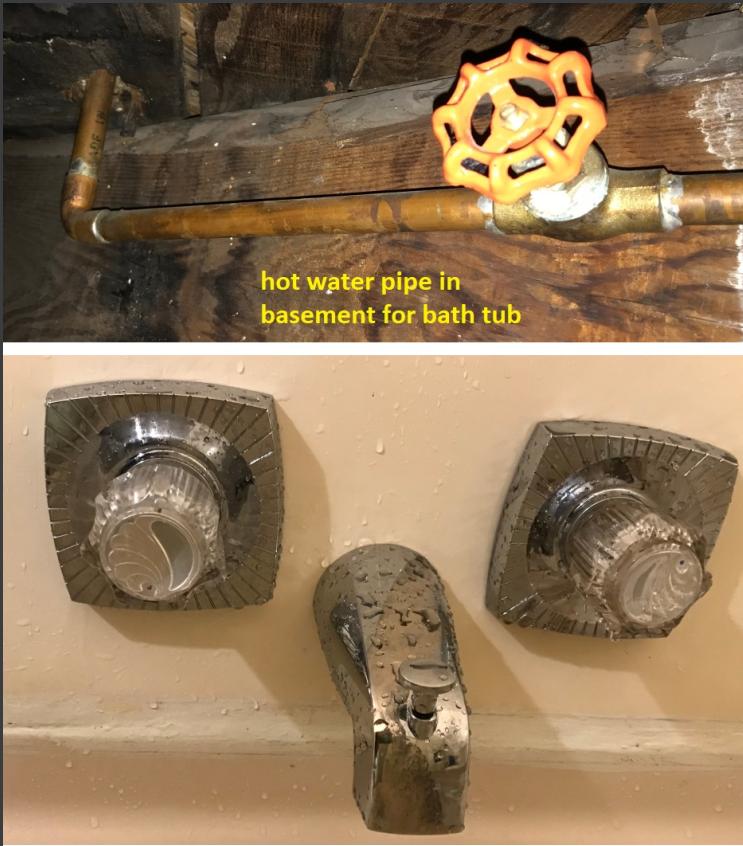

There are copper pipes everywhere for hot and cold water

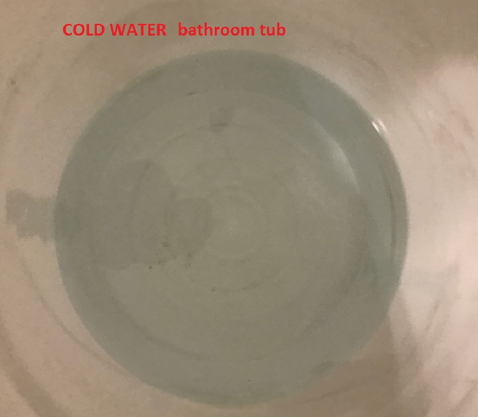

Black stuff comes in all faucets in the house only with hot water.
Please check pictures(click to zoom in) for more information.
Can you please tell me how to fix it?
Thank you so much

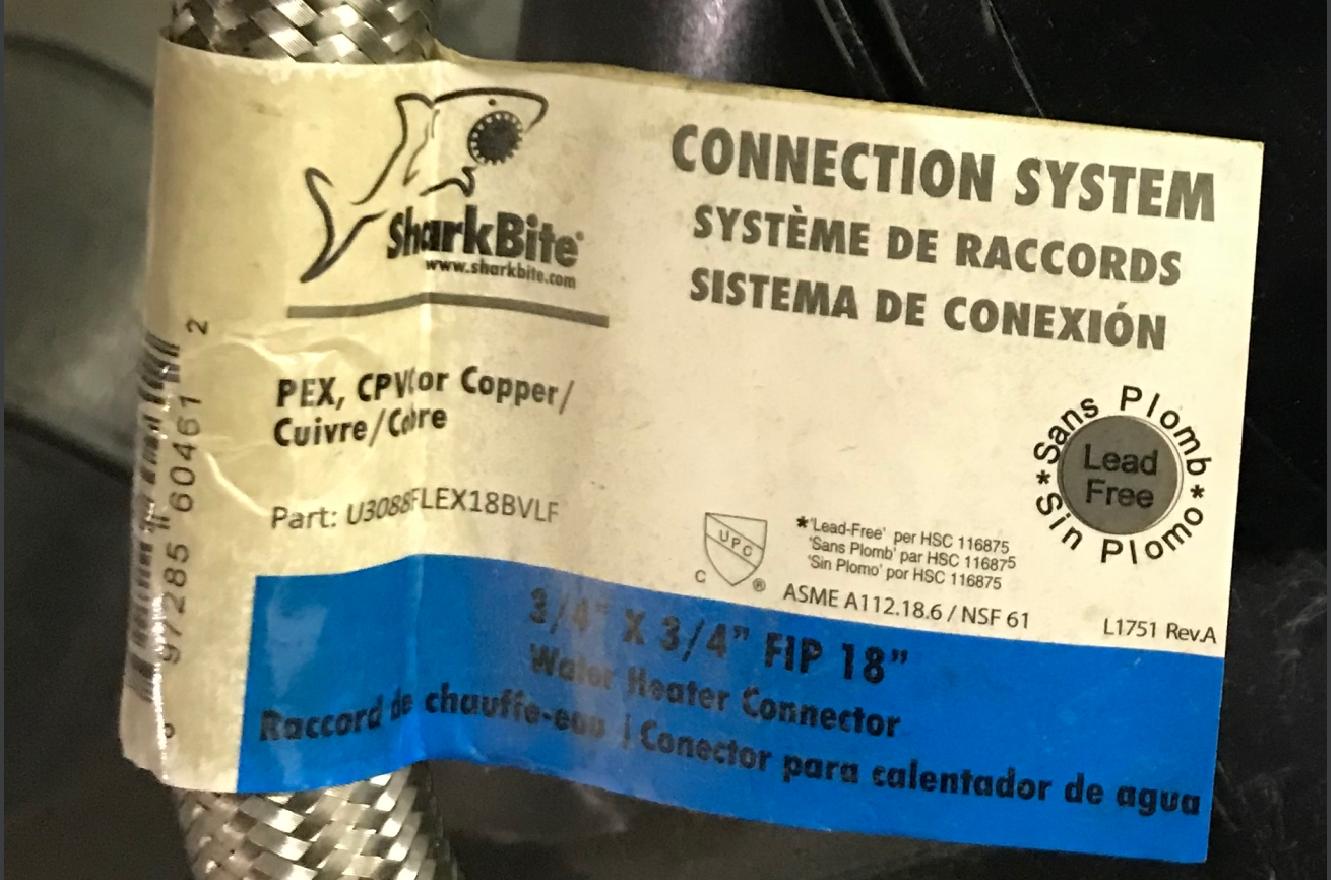

Change the flexible hoses on your WH to corregated stainless steel or copper rather than those hoses, which have a plastic/rubber core.

Time to change the Sharkbite connectors. There are dozens of posts "on black particles in our water" .

just change out the flex lines on the heater and flush out the unit and the problem will go away
