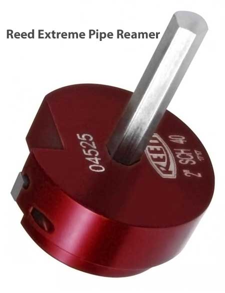

How much vertical do you have to work with? If the outer is the hub of the 90 then the inner part can be reamed out.
They make these for all sizes of pipes including 3" and 4"
You might also consider using an repair flange that fits inside the pipe.
The spigot end can be cut shorter.
Or...........you could cut plywood and replace the 90 too.

q: for the repair flange above would I need to use the reamer also you think?
it appears I would need to at least knock down some of the remains of the old flange just to bring the height down to the existing 4” pipe height.

So if that is 3.50 inches inside, you probably cut out a 4 inch x 3 inch closet flange such as https://www.ferguson.com/product/pr...with-stainless-steel-ring-pf4134a/_/R-3585832 . That is made to glue into the end of a 4 inch abs pipe, or outside of a 3 inch abs pipe. If that is the case, that elbow down the hole has a 4 inch spigot input. So it would not have a 4 inch hub that you could use, and the Read reamer made to cut a pipe from a 4 inch hub would not work for you. If the inside of that hole you have is not square/straight, you might have to address that. The hole you have now would match that of a 3 inch hub.
