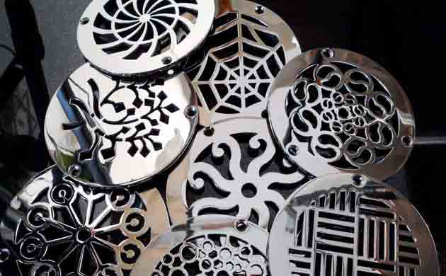

Thanks Doug. Great project.
I think the grill needs to be custom. Can you make a new grill cover out of a scrap tile?
Maybe cut some slots in.... Drill some holes (maybe at upward angle making them ovals).
I think the white grill at that elevation takes away from the look of your great tile job. I would make a new grate or grill. Maybe spray paint it a colour closer to the tile....
Maybe the folks at the Designer Drains can make one for you. Custom Baby.
I think you need to throw another $150.00 at this job. Then your done done.

I don't like the grill either. I was going to look for a 4" nickel or brushed stainless. You have any sources of supply?

You have a nice bathroom there , Doug . Great job !
I would recommend you something chromed for that environment -- grill replacement -- , maybe something custom .
The easiest way would be just to chrome the plastic grill you have in there . Not sure how long it will last , but will definitely make it look nicer . :)
